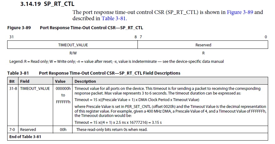

I am using the DSP C6638 SRIO interface with IDT switch to communication with other DSP C6482.
With the Nwrite transaction only sometimes I get the SRIO LSU Hang such that no shadow registers are available.
I using the LSU flush to clear the stuck transactions temporarily.
Queries:-
1. What is the behaviour of SRIO SP_RT_CTL ? (currently using the default value as example). After the timer expiry will it discard the ongoing transaction or not ?
2. What is the default DMA clock period in below equation?
Timeout = 15 x((Prescale Value + 1) x DMA Clock Period x Timeout Value).
I am using :- PRE_SCALER_SELECT = 0x8, PRE_SCALAR_CLOCK = 0x10  // 156.25 Mhz, PORT_RESPONSE_TIMEOUT = 0xFF0FFF
2. After SRIO Flush , further SRIO transactions work normally. Why ?
3. How can I check the TX/RX buffer status ?
Mahesh
    Ans1: If time expires, an error should be logged in the ERROR MANAGEMENT RapidIO registers. The response timeout is handled exactly like any other error condition. The LSU will wait for the CPU to send it a flush or a restart command. The RapidIO specification states that the maximum time interval (all 1s) equates between three and six seconds. For more information refer section "2.3.2.5.1 Timeout" on SRIO user guide document.
