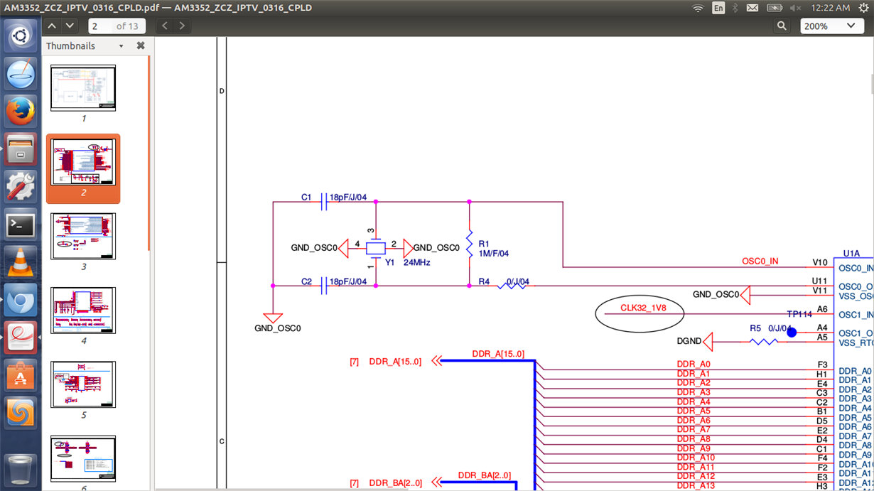

  • SS. lsusb we are looking in host -- HOST is PC only. sorry i forgot to post lsusb log.
    for vbus - error is this link will help ??
    https://e2e.ti.com/support/arm/sitara_arm/f/791/p/324491/1129388
    Schematic:
    VBUS wire jump_v1.pdf

  • Viswanath,
    Please try to remove the external pullups, if USB still does not work, please provide the schematics for review, I suspect you have hw design error which causes VBUS_ERROR.
    (Deleted the post, since schmatics is provided above. I will review it and post comments here.)
  • Viswannath,
    1. Please remove the external pullup on D+;
    2. R231 - '0/J/04_DNE', is this populated? if so, please remove it. The ID pin has to be floating to let MUSB work in device mode.

  • Yeah, I noticed it after my response. Sorry for missing it.
    I have posted my comments for the schematics in my previous response. Please let me know how it goes after the hw change.

    Previously your log showed 'full-speed' but now it is 'low-speed'. Please double check your USB wires on the connector to ensure D+/D- are not swapped.
    If wire connection is correct, what is your system clock? Is it 24MHz? If not, please ensure your u-boot has set the clock register correctly.
  • [91080.884059] usb 7-1: new low-speed USB device number 10 using uhci_hcd:
    I didnt changed any wire - it is same -- only things is earlier --pullup is there -- now NO pullp -- that is only the difference -- YES ofcourse -- based on the VBUS line -- might the speed concludes -- AS you suggested i removed the external pullup.
    i saw the u-boot code-- which is setting for 24MHZ in the clock_am33xx.c file --in arch/cpu/armv7/am33xx. we didnt modified any thing .
    My question is that does your board use 24MHz crystal or other one, such as 25MHz?

  • YES -- it is 24MHZ crystal only we are also using.
