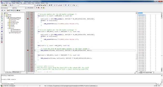

    Thank you for your response, first I thought the same that  the modified code has injected some error, but then I checked with the original sample code to make sure the sample works fine, and reported this outcome actually based on the original sample code.
    I have attached the snippets for your reference which was taken with the audiosample code, without any of my modified code.
    And I did not connect any input to the Line In of the OMAP L137 card.

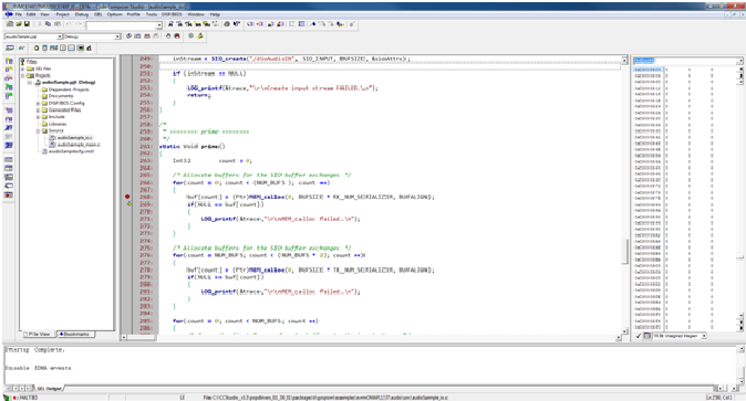

    This is what i saw when I kept the BP, in the function prime ()
    1. It initialized the memory location's to 0 as intended for both the buffer's.
    2. First entry inside the for loop shows the empty buffer on the address function pointer

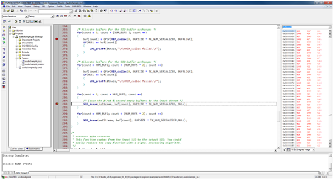

    2.In the second entry, the values changed when read  the memory of buff[count] which were 0's before.

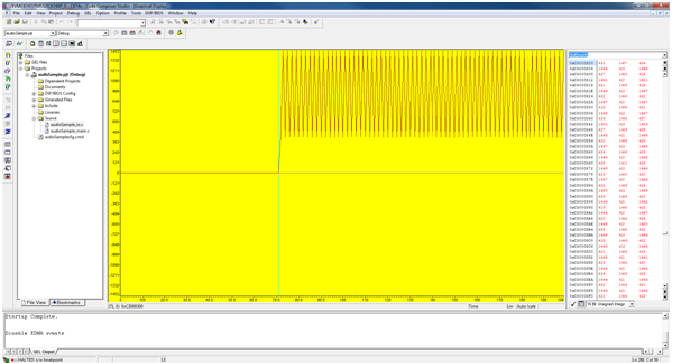

    When I viewed the graph at the same location after it hit the BP, this is what I got for buff[count]
    Can you kindly let me know, why its pushing these data's, when there is no input in the line in, and the memory address has been initialized prior to entering this for loop.
