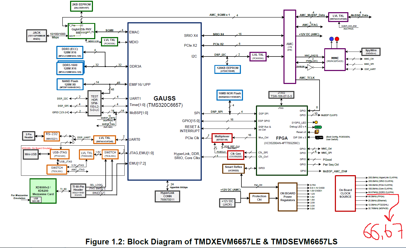

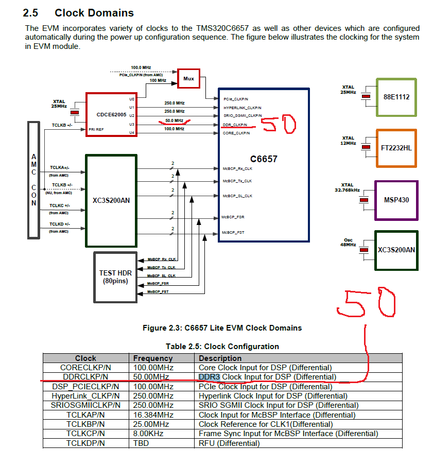

Clock Domains TMDSEVM6657LS
What is true for the frequency of DDR3 50 or 66,57
Why different frequency?
typo?
