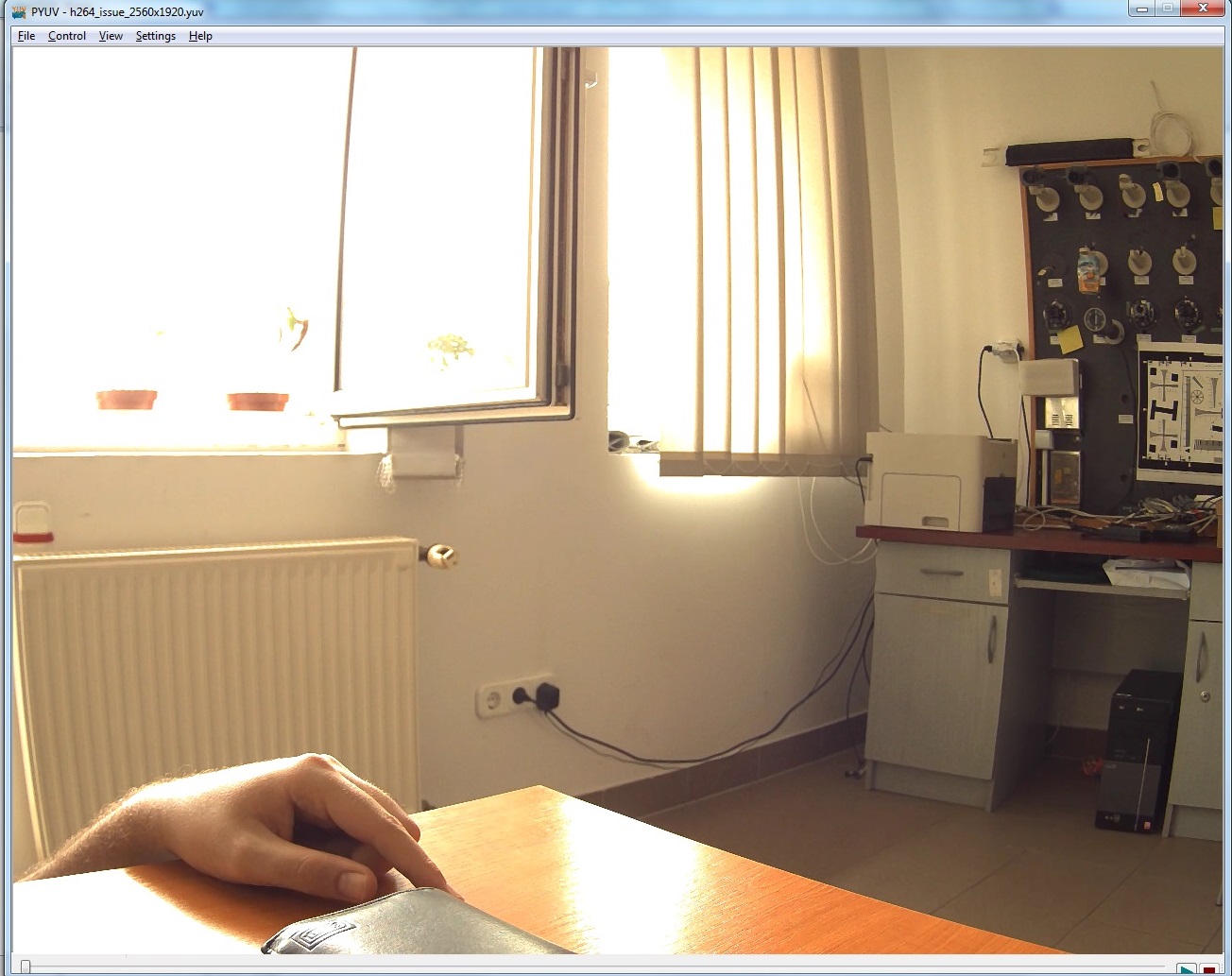

When using the H264 decoder on our DM8147 and the result has strange macroblock-like artifacts on the right side of the image.
Input:
  • device: DM8147
  • codec: H264VDEC_TI DEV.500.V.H264AVC.D.HP.IVAHD.02.00.15.01
  • input: H264 frame created by the TI H264 encoder
Result:
After decoding any frame the output YUV420SP image always has weird macroblock-like artifacts on the right side like it incorrectly slided the whole image to the left a bit. These artifacts are present on Y, U and V planes.
Before decoding the luma buffer (OUTPUT_BUFFER_Y, size 13381632 bytes) is set to zeros (black) and the chroma buffer (OUTPUT_BUFFER_UV, size 6690816 bytes) is set to 0xFF (green) values.
The decoder is used with frame level process call and is expected to decode only I/IDR and P frames up to 4096x3072 resolution (High profile 5.1).
What parameters cause this behaviour? The artifacts appear on all resolutions tested from 640x* to 4096x*. Should the decoder be called with a header-only decode first?
Input H264 (INPUT_BUFFER): http://www.karsiac.com/ti_h264d_ra/h264.raw (2560x1920)
Output YUV420SP converted to JPEG: http://www.karsiac.com/ti_h264d_ra/h264.jpg (see green (UV value 0xFF) artifacts on right side)
