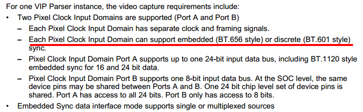

    from datasheet ,we found the vip port can do that :
it tells us that VIN port can received BT656 signal or BT1120 , their embedded sync code word must be FF 00 00 XY

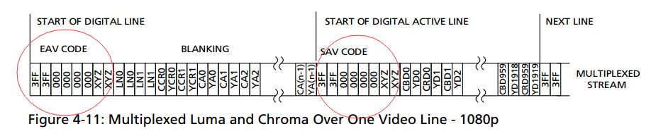

and  we also see the datasheet of GV7601 , when its Multiplexed mode ,  their embedded sync code word is FF FF 00 00 00 00  XY XY ,
it is  Non-standard . see the follow figure:

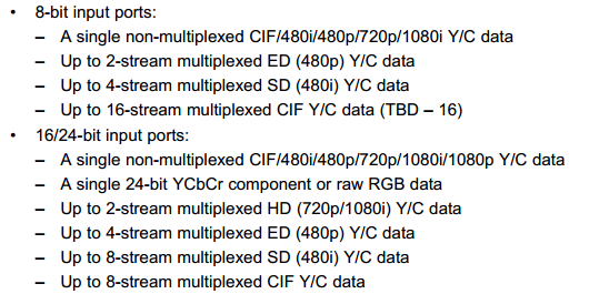

now we want to use DM8148 or DM8168 to receive the GV7601's signal with Non-standard embedded sync code word (FF FF 00 00 00 00  XY XY),
what should we do ?
Could you give me some advices ?
