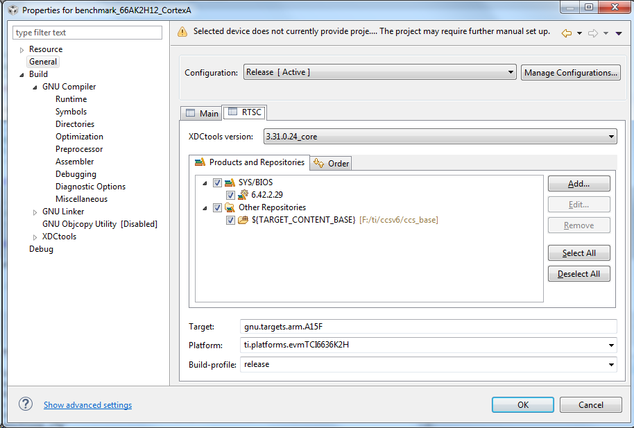

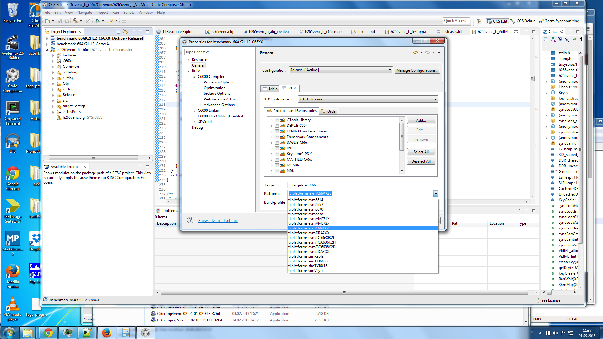

I just received my EVMK2Hx and I am currently trying to get the bench loop example running on the ARM as well as on the DSP. So far the DSP example appears to be working with the following settings:
The thing that bothers me a little is the AK2E, while I am actually using an AK2H, but I guess that does not make any difference, correct?

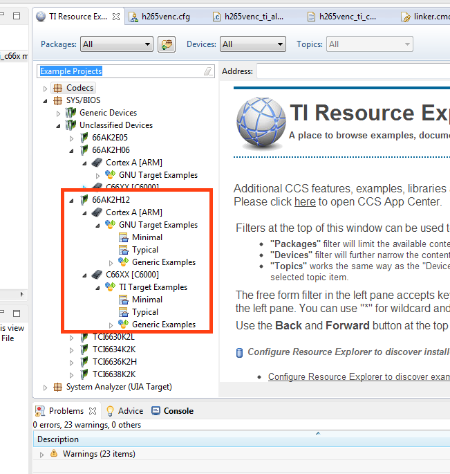

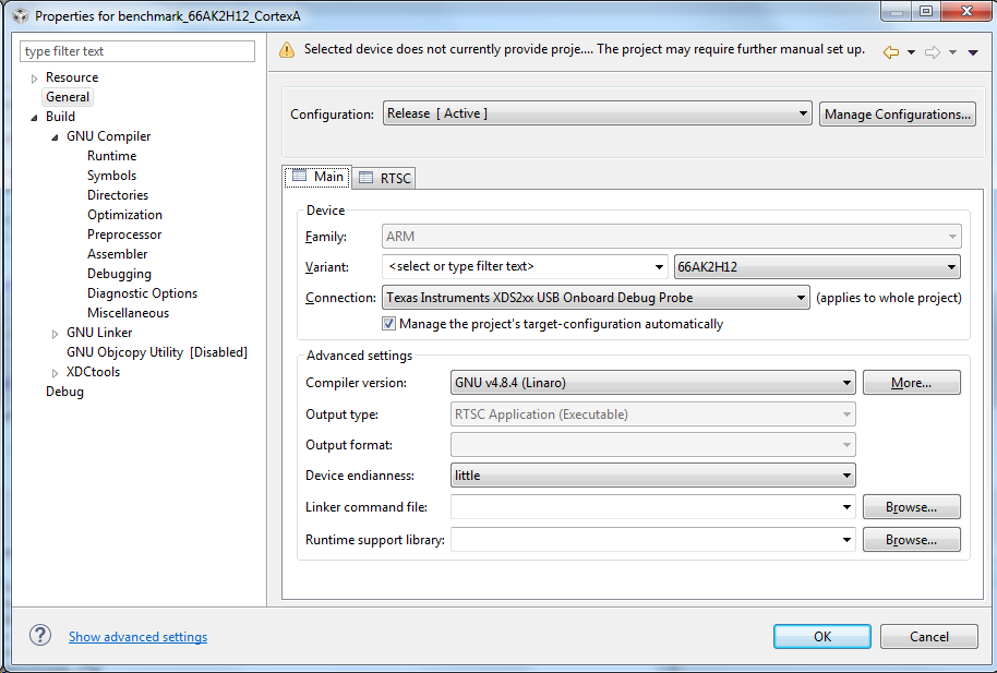

But for the ARM core, I can't get the example to run at all.
It bothers me a lot more that I select the TCI here, is the 66AK2H not supported yet?

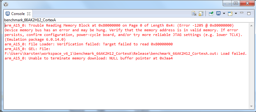

The code compiles, but when I run the code on the board, I get the following message:
Any ideas?
