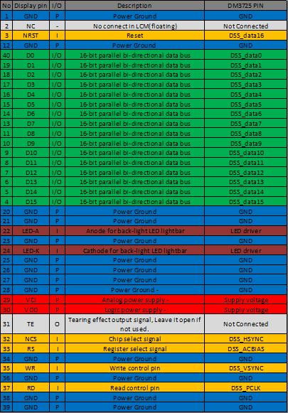

We are developing device based on DM3725 and having queries on LCD interface, below are details:
1. Selected Tianma LCD controller(TM022HDHT5) and LCD part no ILI9341.
2. We are planning to use parallel interface and our display is configured 8080 16-bit parallel interface.
Can I use parallel interface in bypass mode or I have to use in RFBI mode.
There is no  VSYNC and HSYNC lines so where should I connect this lines.
Please help us to solve this issue.
