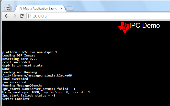

I am using EVM2E,
The IPC demo on Matrix Application Launcher works fine previously,
after updating the linux kernel using images from
ti/mcsdk_linux_3_01_03_06/images
I do it using:
root@keystone-evm:~# mkdir /mnt/boot
root@keystone-evm:~# mount -t ubifs ubi0_0 /mnt/boot
and replace these two files:
uImage-k2e-evm.dtb   uImage-keystone-evm.bin
after rebooting,everything is fine,
by the IPC Demo is not working any longer.
The information are shown as the picture below:
but it works again if I flash the factory image back ,
Any help in this regard is appreciated.
