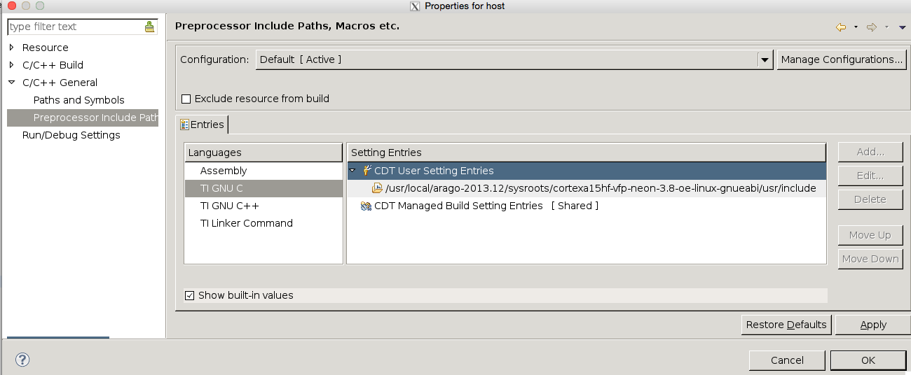

I searcher and found a couple of posts dealing with include options in CCS but nothing that helped me. So:
I'm trying to build a Keystone2 example project, ex44_compute in CCStudio 6.
I imported the whole ex44_compute project into CCS (Import-Import…-Existing code as makefile project) which worked fine, but building failed with missing include file (apparently I need to point out a sysroot) I then changed the setting of the host subproject in CCS, C/C++ General/Preprocessor include path and added the path under CDT user settings (see attached screenshot). But when building again, the host project still fails and it seems to me that the setting just made is not used.

As you can see on the command line for MainHost.c there are two –I arguments present, but neither of them were what was set for the host project according to the screenshot.
