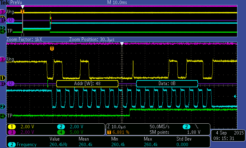

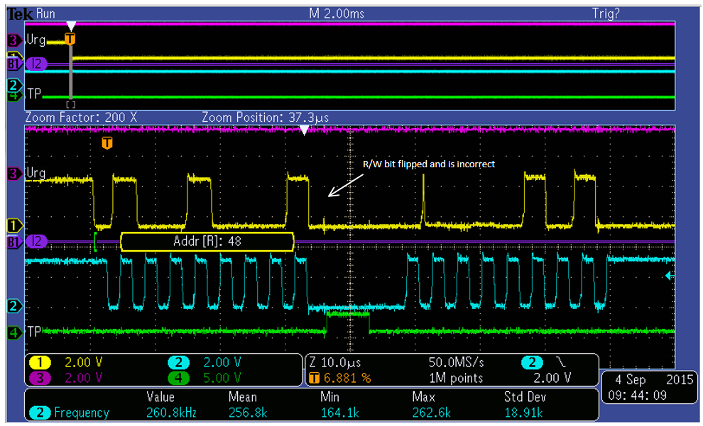

I am seeing an issue with the C5505 DSP I2C configured as the lone master on the bus where ~1 in every 1000 or so transactions the C5505 will flip the R/W unexpectedly sending out a read first instead of a write then read during a repeated start type transaction.
Any thoughts as to what would cause the master to do this?
My test setup is as follows
Every 1 sec
I2C_read(&RxBuf[0],11,0x48,&regnum, 1,1,CSL_I2C_DEFAULT_STTSTP ,CSL_I2C_MAX_TIMEOUT,1);
On the bus are a few I/O expanders and an MSP430F5342. The master, using a repeated start writes a 'register' in the 430 (0x0B), then reads back a pre-determined number of bytes (11) for this register. During this loop, no other device on the bus is being written to or read from. This occurs for any combination of register values and number of response bytes.
Screenshots:
  1. Correct write from C5505 to MSP430
  2. Correct response from MSP430 following repeated start and read from C5505 (same transaction as above)
  3. C5505 incorrectly puts a read on the bus first instead of a write

    #2 I have seen it where both the TRX bit and the start bit are being set, but the if I immediately read them back they are not set. When this occurs, the routine runs through its operation normally but nothing is output on the bus until the routine reaches the receive portion of the repeated start transaction. At which point I believe it is writing the second have of the transaction correctly, but failing because first part of the transaction is missing.
    S, 48W, 0x0B, S, 48R, 0x01, 0x02 etc....
    I believe what is happening it fails to write S, 48W, 0x0B (either because the TRX is not set or the start bit was not sent, not sure), but then successfully writes S, 48R, making it appear as the R/W bit has been flipped.
    As in mentioned in the previous post, moving the Tx mode set, into the first if(masterMode == true), but before the start bit is set seems to correct the issue.
