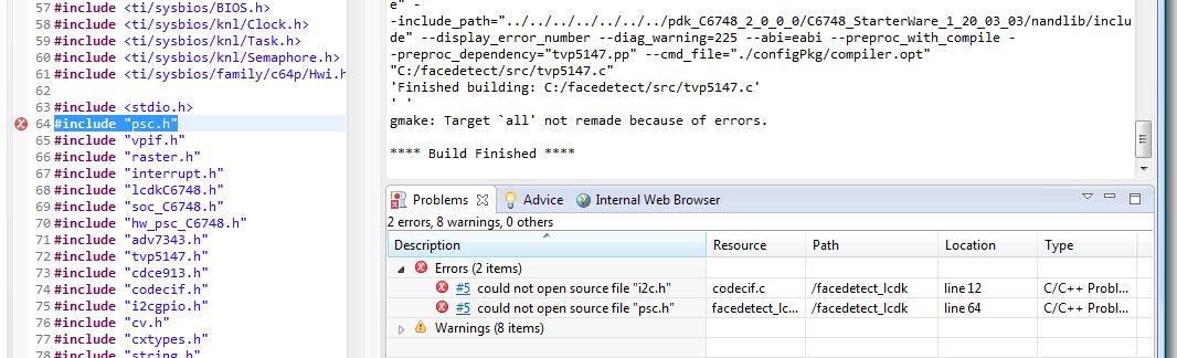

After setting all the software tools (CCS v6.1, SYS/BIOS, etc) and testing the C674x LCDK platform  with a SYS/BIOS program now I want to run the "Face Detection" demo project.
I imported the project within CCS. When building the project, I am getting two errors: (1) could not open source file "i2c.h"; and (2) could not open source file "psc.h" as shown in figure 1.

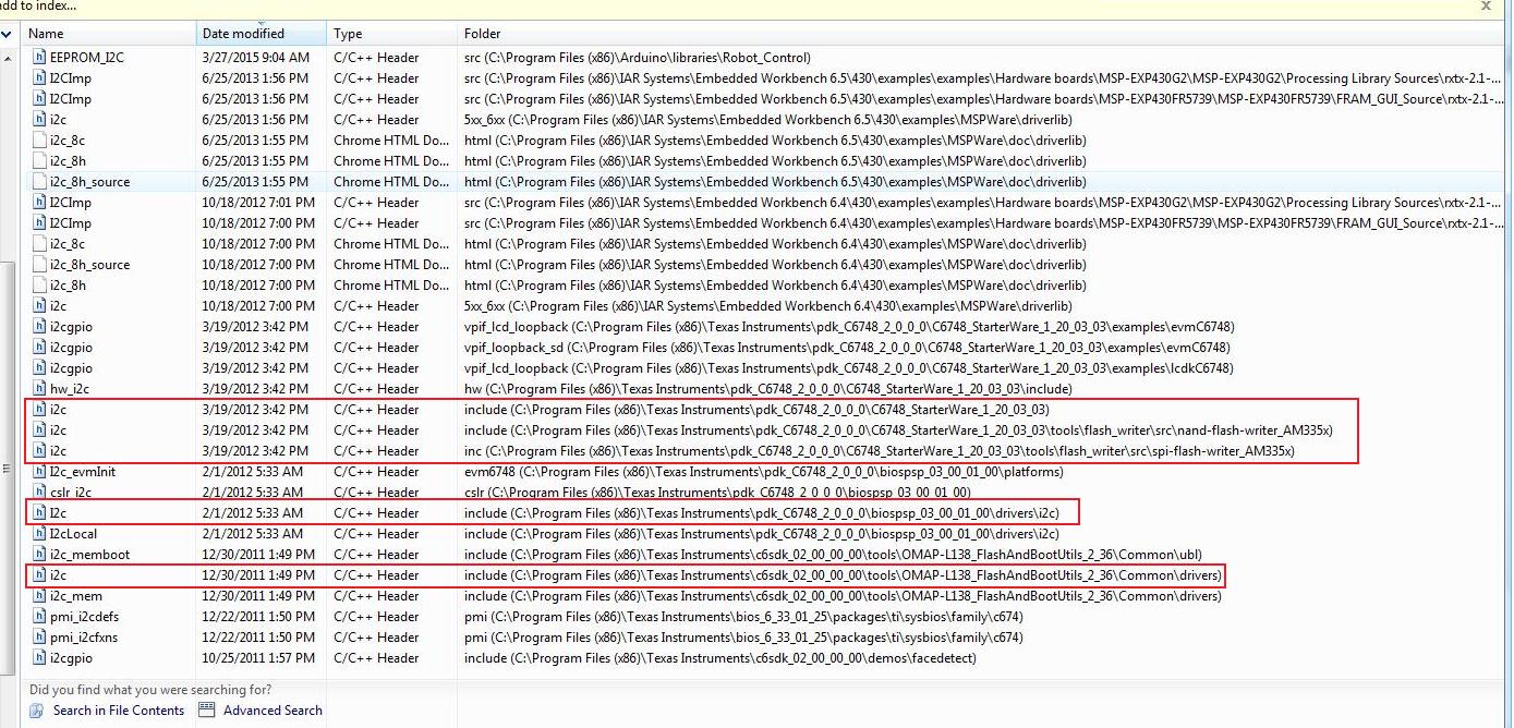

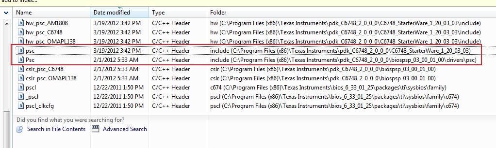

Searching in my computer I found the following source file versions (shown in Figure 2 and Figure 3 within red rectangles).
Figure 2.- I2c.h files
Figure 3.- psc.h files

  • Hi Frank,
    By seeing your screenshots, you have installed "biospsp" and "starterware" packages.
    1.- Which ones are the proper files to include in the face detection demo project?
    As you are using biospsp.
    You need to include "biospsp_03_00_01" include path.
    2.- Is the "CCS Build --> Include Options" the best way to add the path to the corresponding folders?
    Yes.
