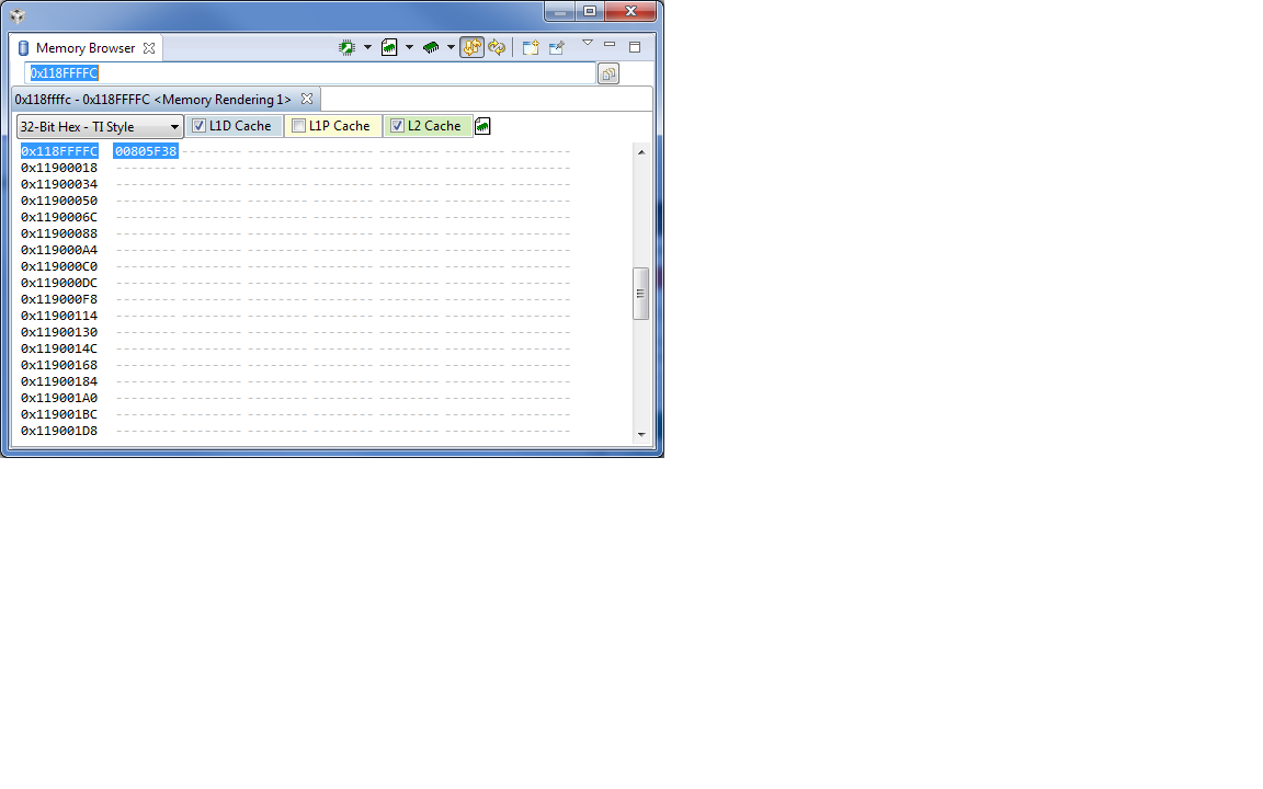

    Thank you for the prompt reply. I want to load core 1 via core 0 as in example in bootloader mode using pcie or srio.
    As I mentioned in the previous post  I have noticed that the KICK0 and KICK1 registers are not editable.
    How can I do in this way?
    Best regards
    George

    By mistake  I put my answer in other post.
    Unfortunately no.
    The core 0 cannot wake up core 1. I follow the steps that are described in the previous post , but I do not the code for the uart.
    In the magic address  the write_boot_magic_address function address has been written.
    But I have erase the default bootloader in the evm board. I do not know if this an important factor.
    Thank you in advance
    George.
    I have attached the code that I try to execute.
    Please also find the target configuration

  • Hello
    Regarding the first bullet , in the image that I attached the program has written in the correct address,
    the address of the function that is executed by second core.
    About second core could you please clarify what you mean "power cycle every time"
    I have followed the instructions. I have connected in the first core , I ran the code and then  I paused the execution and I check the L2 memory of the second core.
    How to check if the IPCGR  interrupt takes place?
    Best regards
    Lets assume, you have connected core0 with gel file then the application (.out) file is loaded and run using emulator for first time(I am considering this as a cycle).
    If you want to run same/different the application on core0, please switch off and on the EVM again.
    Thank you.
    I have done this with no effect
    Best regards
    George

    Regarding the post above. We found what was wrong.
    we have put the const and the test in L2 instead of DDR. However If you put the const and text in the L2 of the first core, you should copy the const and text from the L20 to L21. In addition ,the _c_int00 should be in DDR.
    Thanks for your detailed information and test code. It will be useful for other community members.
  • Hi Giorgos tsoumplekas,
    Thank you for the post however I did not understand the issue. BTW, what is L20 and L21? Can you please clarify?
    Thank you.
  • Hello
    The issue was that we have put the .text and .const in 0x00800000 and the second core could not start the  execution. We solved this problem copying the .const and .text data from the L2 of the core 0 (L20)to the L2 of core 1(L21)
