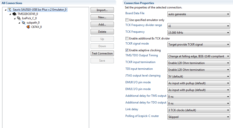

  • Try to enable "Adaptive Clocking" in target configuration.
  • I am enable "Adaptive Clocking" but the error remained the same.
    C674X_0: File Loader: Verification failed: Values at address 0x00000000C0006920 do not match Please verify target memory and memory map.
    C674X_0: GEL: File: C:\ti\Workspace\McASP_EDMA\Debug\McASP_EDMA.out: a data verification error occurred, file load failed.

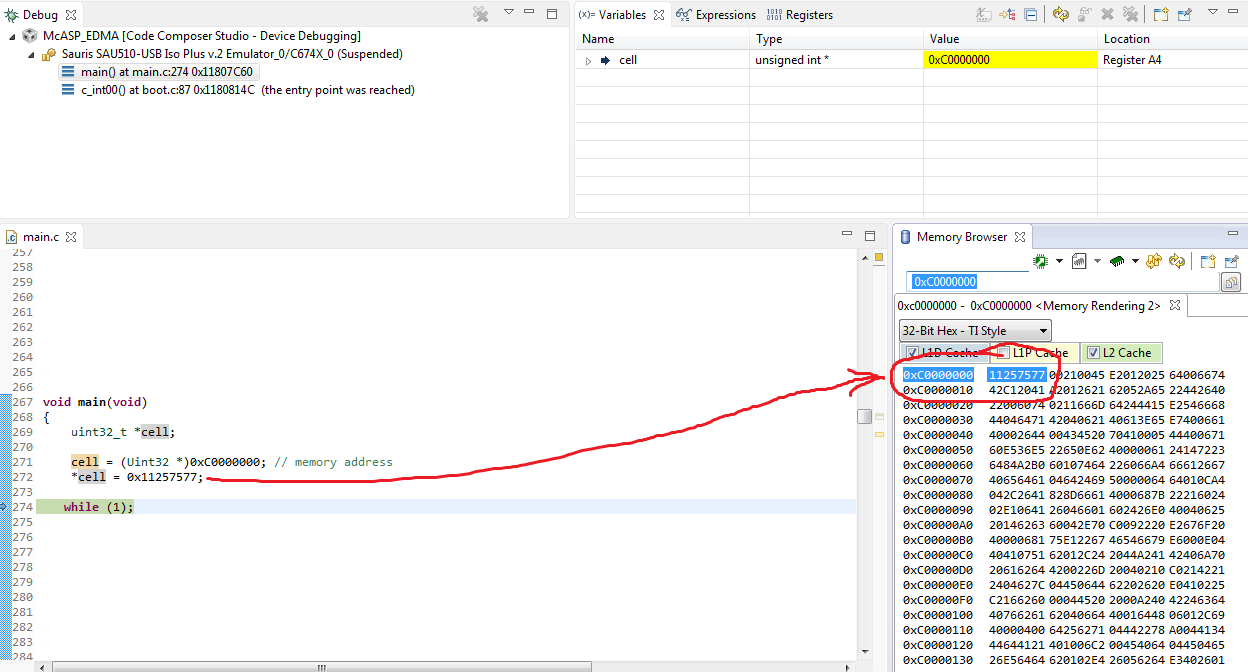

  • I am added  the  some information:
    I am configured a cmd  file for writing to SHDSPL2RAM. Then I am  tried to write in SDRAM  at address 0xC000 0000 -> it's work successfully.
    But  addresses only available 0xC000 0000 -> 0xC0FFFFFC (16MBit).
    My SDRAM chip - 64Mb / 4M x 16 bit.
    I am hope for your help.
    Thanks.

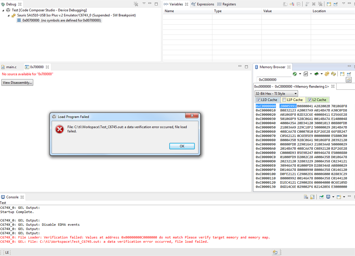

    After connecting the target, able to access the SDRAM memory (C0000000) through CCS memory browser ?
    I have attached the test.out, please try it and let me know the result.
    Test_C6745.zip
  • Hello Titus S,
    Great Thanks for your help.
    I am run the attached test.out and have the following result:
    I tried to write into a cell 0xC0000000  - it's work successfully, but  only available range of addresses: 0xC0000000  -> 0xC7FFFFFF.
    Thanks.

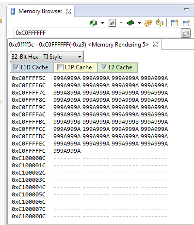

    For C6747, you can interface 256MiB SDRAM address and for C6745, only 128MiB SDRAM can access as per the C6745 memory map from data sheet.
  • I'm sorry, I was wrong:
    Available range of addresses: 0xC0000000 -> 0xC0FFFFFC (16MBit) - only 1 bank.
    How did you execute this code for writing on SDRAM address ?
    Internal RAM used ?
    What are all the things you modified in gel file ?
    Have you modified the correct SDRAM parameters as per your SDRAM data sheet ?
    I am using Internal RAM.
    I am modified gel file (Pinmux, Pll, PSC).
    I am modified the correct SDRAM parameters per my SDRAM data sheet.

    I noticed a strange behavior on pins: BA0, BA1 (Bank Activate).
    When I read the memory in memory browser from 0xC0000000 to 0xC0FFFFFC - I see multiple signal change on the above pins.
    When I read the memory in memory browser from 0xC0FFFFFC to 0xC7FF FFFF - signal doesn't change on the above pins.

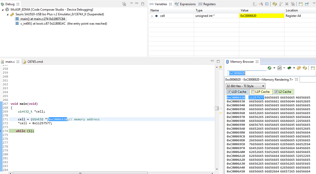

    I don't understand where taken this [0x00000000C0006920] address ?

    Try to access (read & write) this SDRAM address "0xC0006920", check the memory map of that project (*.map).
