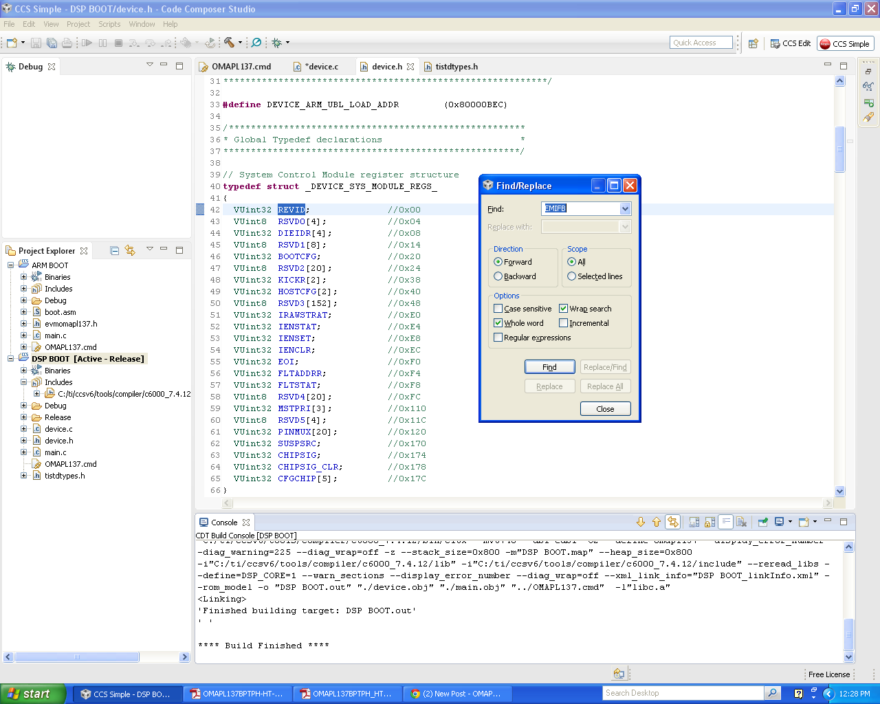

                   Am working on OMAPL137 and am using CCS V6.  So, i wanted to search a register name in the  entire project and give me results. But, am not able to find the search option for all the files included in my project. Am finding option to search only in file. So, can anyone please let me know the search option in the whole project??
Also, i have attached the file where am able to find the search option to find register name / variable name for only file in the entire project. But, i want to find the search option to find register name / variable name   in all the files of the entire project.
Waiting for your valuable inputs at the earliest.

    Select the string that need to search, then do right click -> Search text option -> project or workspace

    As Titus suggested, able to find out the text that you are searching ?
    You may not find the exact name in project code as used in data sheet since developer might have used different name for some meaning in register and variable.
    So try to find out with some different names.
    Also, you can import the dependent projects & libraies and do search with option search in "workspace"
