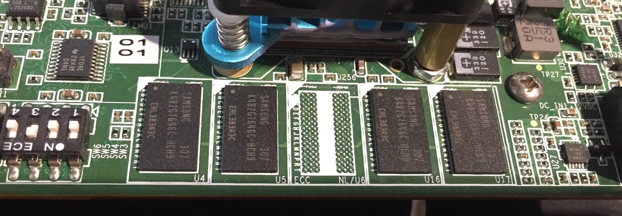

Second question, why the ECC DDR is missing on the 6678EVM that we purchased from TI(picture showing below)?
    The EVM has the full 512MB of DDR3 on board.  That U6 pad would be used for the support of ECC memory bank.  It was designed so that testing could be done for ECC, but the production build doesn't include the memory bank for ECC support.
