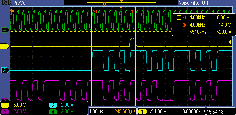

    We have noticed that the transmission wave starts before the frame sync pulse

  •  Hello,
    We use CLKR/X and FSR/X signals on the C6654  .
    Please find in the attachment the wave that show the problem that we have.
    Actually you can see blue line that data transmission starts almost 8 clocks earlier that the frame pulse.  We have configured 32 8bit only transmission in order to be clear where the problem is represented.
    From MCBSP configuration we cannot find something can cause this behaviour or to delay  the data transmission more that 3 bits.
