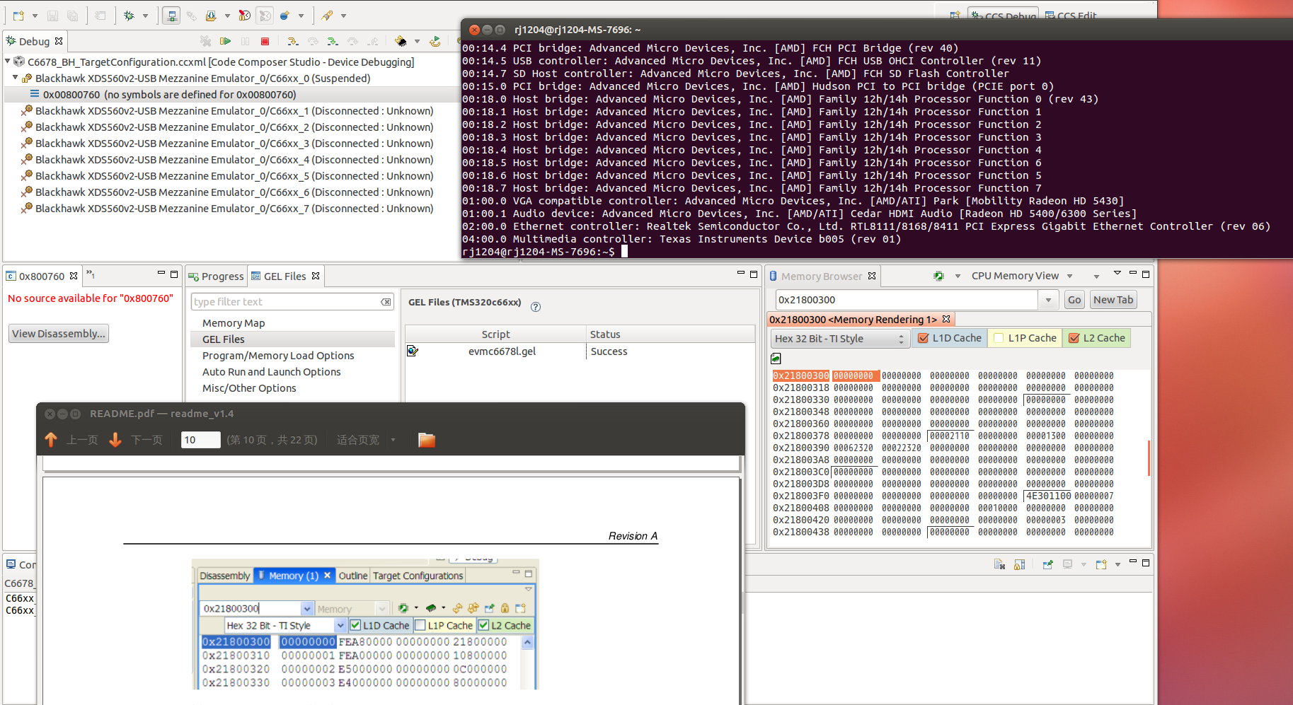

Is the memory content right for this pcie card (6678EVM)?
The C6678 EVM is correctly identified by host Ubuntu PC (12.04), see below picture please. When I follow the README.pdf of folder: /home/j04/ti/mcsdk_2_01_02_06/tools/boot_loader/examples/pcie/docs, it gives a figure about memory of address 0x28100300. There are non-zero contents about IB_BARn, IB_STARTn_LO, IB_STARTn_HI and
IB_OFFSETn in that .pdf document.
When I check my 6678 EVM memory of address 0x28100300, it shows all zeros. I don't know whether address 0x28100300 is not the right address, or something I don't know yet. Could you find something wrong in the figure?
