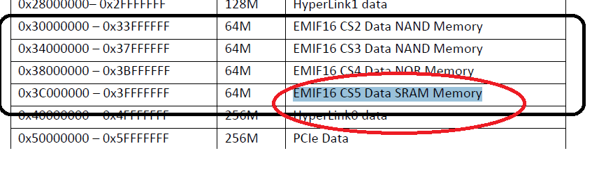

    On the software side, two things are required.
    1. Modify the dts file.
    2. Enable the sram driver using "make menuconfig"
    Go to k2hk-evm.dts located at arch/arm/boot/dts/ and modify like below referring to the XTCIEVMK2X_Technical_Reference_Manual_Rev1_0.pdf
    Example:
    aemif@30000000 {
    sram: cs5@0x3C000000 {
          compatible = "mmio-sram";
          reg = <0x3C000000 0x40000>; /* 256 KiB SRAM at address 0x3C000000 */
    .......... // for other NAND/NOR e.t.c
    linux-keystone#make menuconfig
    -->Device drivers -->Misc devices --> Generic on-chip SRAM driver
