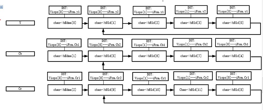

question about the ddk video port driver
hello, I'm studying the video port driver , in the source code in "vportcap.c" , there is a  function "_configTransfer", it build a link as bellow based on the "chan->mergeFlds"
or
but I don't understand why the program used the edma like this , also I found the edma ISR" static void captureEdmaISR(Int tcc) " has a parameter tcc, how this parameter passed to this ISR, can anyone help me.
