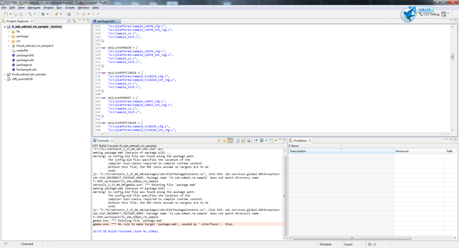

However, it still don't work. Someone said he made such changes and rebuilt the edma3_lld_rm_sample.ae6 making the program work, I don't how to do this, so I didn't do this. Does this really work?

    I am sorry to reply so lately. For the first thing I read the EDMA3 controller User's Guide, I know the transfer channels of one TC would not open simulataneously, but I don't think it matters. My project use 8 cores work together, and each core corresponds to a region, so the channels of the different cores could transfer together as you say. Now, my problem is how to make each core have three channels to transfer data.
    Your second suggestion to rebuild the source code of edma_lld_rm_sample project, I don't know how it works.I try to import it to the CCS, and rebuild it with the edited sample_c6678_cfg.c file, but it has compile errors. Then I don't know what to do.
