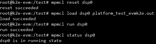

Loading .out from CCS using MPM
  I am using EVM2E,and the PDK demo works perfectly in CSS debug mode,
  The leds will blink according to   test_led().
  Path:
  \ti\pdk_keystone2_3_01_03_06\packages\ti\platform\evmk2e\platform_test0
  But when I copy .out file (elf)  from CCS,and load it using MPM in Linux :
  It's not working, I can't see the LEDs blinking.
  Any help on this will be appreciated!

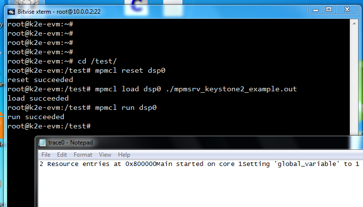

    Hi Rajasekaran K,
     Thanks for replying!
      I try to load the mpmsrv example as you mentioned,it works perfectly:
      I think you are right, no problem with the MPM.
      Could you please give some advice on how to fix the resource conflict problem?
      Thanks you!

  • Hi Kevin,
    I read your answer carefully, but it seems focus more on the Linux side, but the DSP should be uesd to control the hardware,Linux just load the .out file.
    Please find my understanding below:
    As of now, the ARM ( Linux kernel) controls the GPIO lines. If we need to access the same resource(GPIO) using DSP then we should make sure that the ARM is not configuring/using it.
    Thank you.
