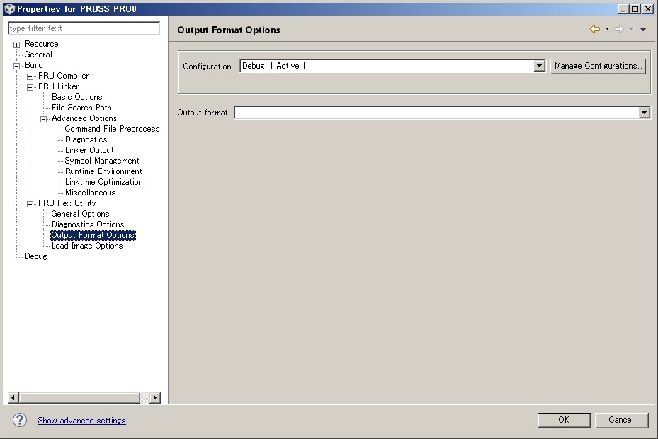

How to create PRUSS binary files.
Now I try use PRU0 bare-metal application.
My setting is output 2 files. text.bin (application codes) and data.bin (data area?).
I load text.bin to 0x4a334000 (PRU0 IRAM).
And load data.bin to 0x4a300000 (PRU0 DATARAM).
But, Data Area (0x4a300000) is not same debug load (.out file by using Emulator).
I want to know correctly flow.
I want to write PUR bin file to SPI Flash. And read and load to PRU from A8 core application.

bni.cmd is
-b
-image
ROMS {
PAGE 0:
text: o = 0x0, l = 0x2000, files={text.bin}
PAGE 1:
data: o = 0x0, l = 0x2000, files={data.bin}
