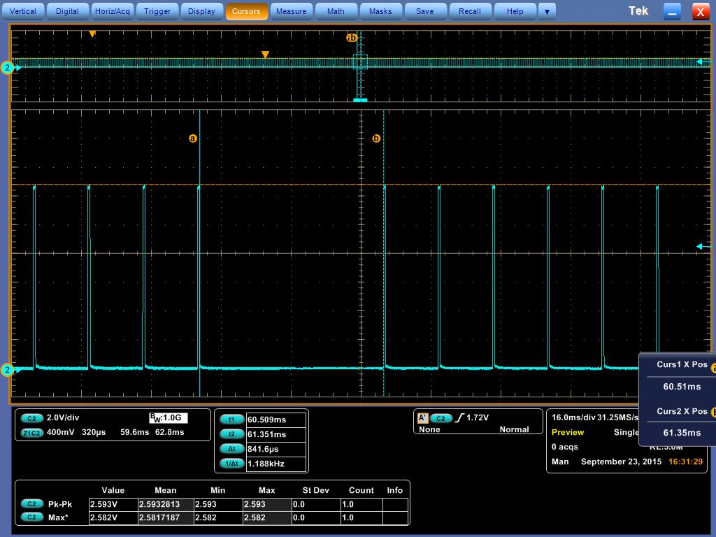

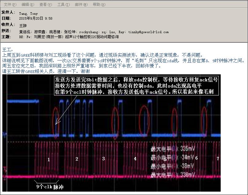

When I test my AM3354 designed board,I found some Abnormal wave shape ,such as:
1.test  buzzer wave(packge pin A13) IO for PWM0A,buzzer a corresponding waveform in time, 20 ms arose among high level and 530 ms low level driver level:

3.I2C2 (connect to CTP)communications SDA waveform expansion plan is as follows, burr peak of 280 ns.

    3. What is the value of the pullup resistors on the I2C lines?
  • Hi,RE as follow:
    1、The eHRPWM driver is from  kernel_gr335x.tar by TI in 2010.The pwm frequence is 4KHz.The buzzer's wave may not normally. It's has 20 us arose among high level and 530 us low level driver level.The wave as follow:

    3、The pullup resistors on the I2C lines are 4.7Kohm,1/16W,5%,0402,SMD.
    I don't see any picture attached. However "The eHRPWM driver is from  kernel_gr335x.tar by TI in 2010" - this is obsolete from a long time. Please use the latest SDK version: http://software-dl.ti.com/sitara_linux/esd/processor-sdk/PROCESSOR-SDK-LINUX-AM335X/latest/index_FDS.html
    Try reducing these to 1.5kOhm if you have I2C issues.

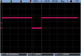

  • HI,RE as follow:
    1、The pwm wave as follow:
    Buzzer works well, but the wave  is unusual, Would  you explain to the following two points exception?
    (1)A response of the buzzer waveform abnormal 550 us or 841 us the low level of drive level (random).
    (2)Of every response waveform in the final buzzer will have a continuous high level of 250 us.

    3、I2C2 communication is normal, buthow to eliminate the waveform of the burr ?Why do you use the 1.5 k replace  4.7 k?
    I have already posted that the driver you use is very old and no longer supported.
    These spikes are the ACK signal from the Slave device. They are quite normal, because the data line switches direction in this moment. 1.5K is the value used in TI reference designs, but there is no need to change from 4.7K if your I2C works fine.
