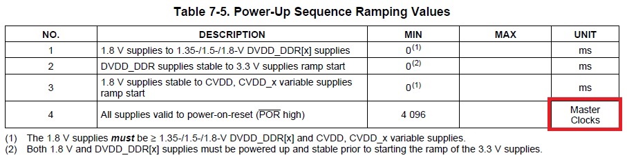

I don't understand what the UNIT "Master Clocks" mean in DM385 datasheet "Table 7-5. Power-Up Sequence Ramping Values".
Could anyone please give me some hints?
Thanks.
Sherry
clock cycles of the main oscillator
(Note that this is not DM38x specific, the same specification is in the DM814x datasheet)
