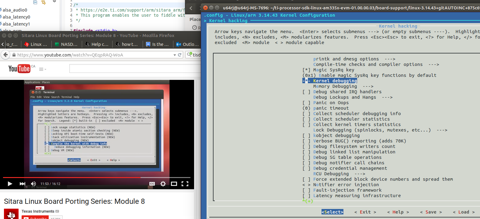

Following video on porting linux with Sitara SDK, it has a 'Compile the kernel with debug info' option. With the new SDK for processor 1.00.00.03 installed on my PC, I cannot find this option. Please see the picture.
Where is this option on the new release SDK for Sitara?
  • I just find an option KDBG: kernel debugger. It looks like the same function with the old option. Thanks

    Right now I do have this option in Linux kernel 3.10 and 3.3.
    Can you check this option "DEBUG_INFO" in menuconfig in your kernel ?
    PS: Use "/" key to search.
    I could find it on Linux 3.18
    I think, you can check the following path for "Compile the kernel with debug info" option.
    Kernel hacking ->
    Compile-time checks and compiler option ->
