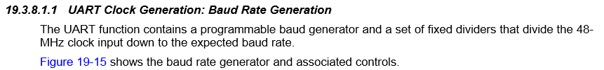

I found in the technical reference of AM335x (table 19-25), that the lowest baudrate of the built in UARTs is 300bps :-(
For a FSK receiver I need a possibility to receive UART signals with 200bps 8E1.
So is there any (unconventional) way to use the hardware UARTs with 200bps? I use Unified YOCTO Linux as OS.

    do you mean, that I can set the divisor value free? In the text above is written:
    So the divisor values seems to be fixed and 0x3a98 is not possible...

    my picture was removed - here it is again:

  • Any divisor value from 0x0000 to 0x3FFF can be programmed in the DLH/DLL registers, there is no hardware restriction.
  • I guess the mention of "fixed divisors" refers to the /16 and /13 oversampling divisors.

    Here it seems, that the DLL and DHL values are calculated without a restriction according the following term:
    port->uartclk/(baud * divisor)
    So may be all my installed terminal programs (minicom, picocom - and I also tried Python/PySerial) dont use the API in the right way?
    I cant believe that? I can set the baudrate of 200bps on all programs - and all terminal programs receive the expected amount of bytes - but they are all wrong - most of them are 0x00...
    I connected also my oszilloskop in parallel and could decode the signal correctly with 200,8E1 settings. So it is correct...
    Do I have to set something within the kernel config or on the console? I found, that there are a MODE13 or MODE16 setting. I would need MODE16...
    best regards
     Mario
  • Hi Yordan,
    finally I found, that there must be a bug in TI's omap-serial.c function: serial_omap_baud_is_mode16() .
    If I simply return the MODE16 decision made from the baud rate value like this:
    return ((baud<=230400)?true:false);
    then it works :-) Then the baudrate of 200 will really be applied!
    I dont understand how the code in this function should reflect the table 19-25 in the AM335x technical reference?!
    So can you confirm the bug? How I can get an official fix from TI for kernel 3.12?
    best regards
    Mario
