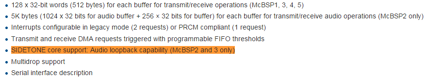

  • Hello everyone,
    Thank you very much for your continued support.
    As per your McBSP guide, both McBSP2 and 3 have audio loopback functionality.
    If they have, it should work on McBSP3. I could not completely understand your last comment. Kindly provide a bit more explanation.
