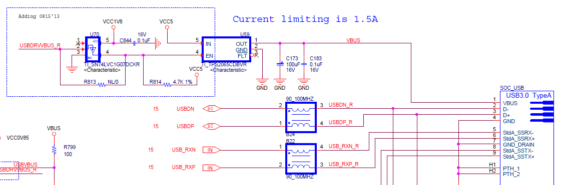

I have made a usb disk to boot k2h. It boot well On rev1.1 evm  . But failed on Rev4 evm. it can't find the usb disk like below:

I have check the schematic, rev1.1 and 4 have different on  USBDRVVBUS_R design.
This is rev 1.1 evm
This is rev4
And under linux both rev1.1 and rev4 usb can work well. it seems uboot should do some modification for rev4 to use USBDRVVBUS_R pin and enable usb power for usb disk.
Could you help to double confirm? and Do we have any resolve method?
