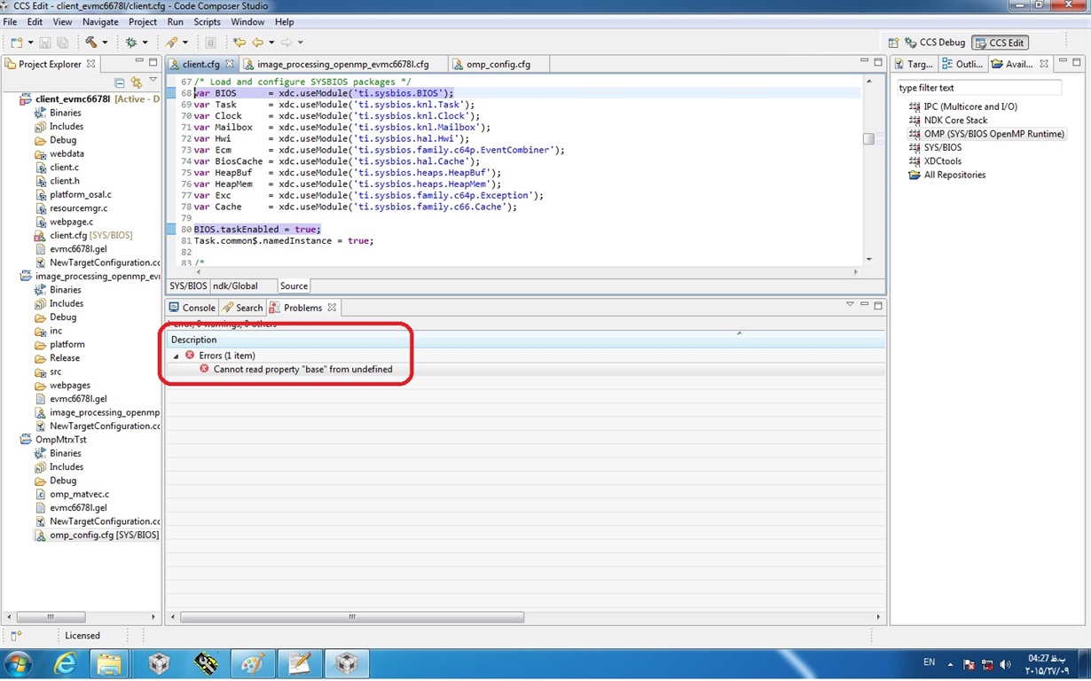

I would make a project with Openmp and TCP connection that DSP worked as client.
So at first I ran "Image_process_omp" project but when I tried to modefied it and maked tcp client by socket, it didn't work, consequently I ran
"client" example and add my socket program and it worked.

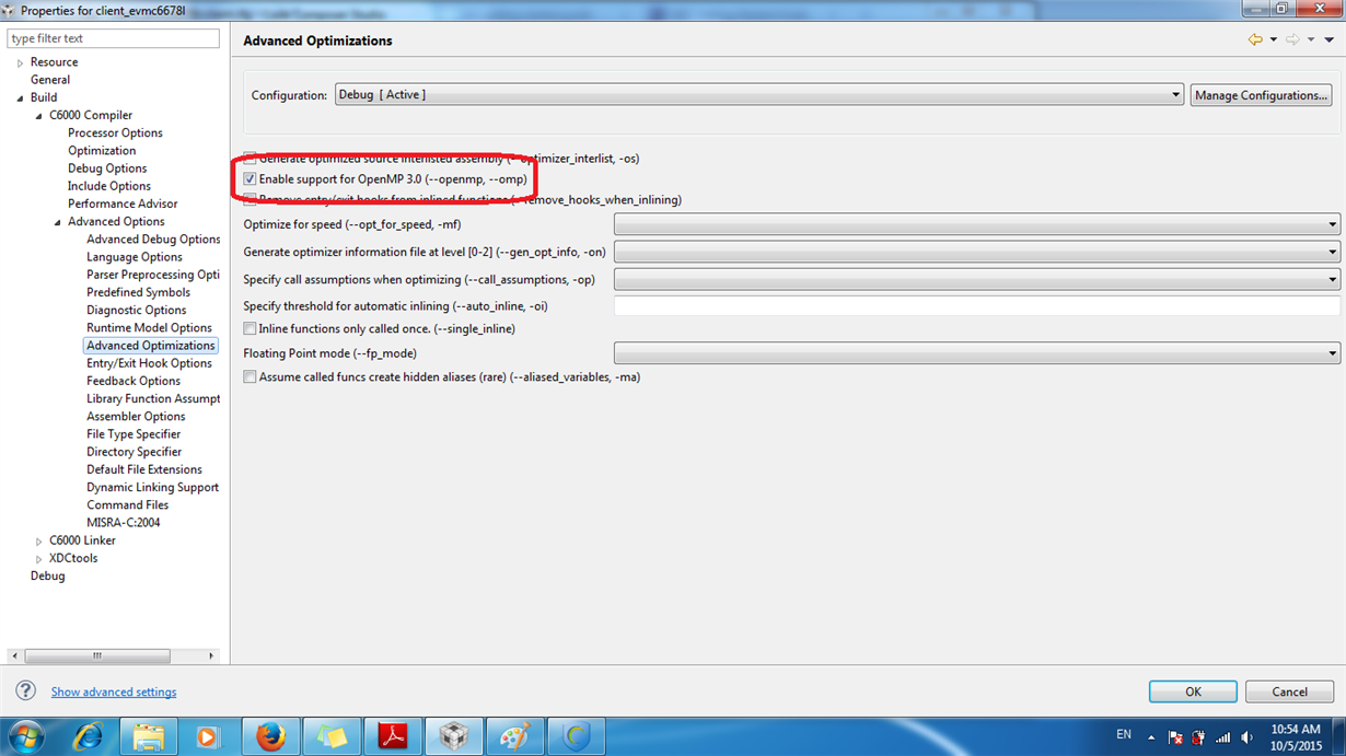

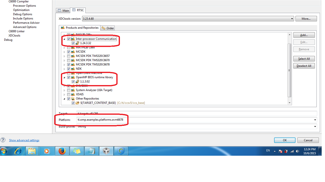

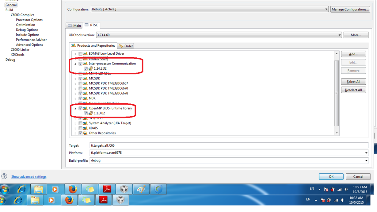

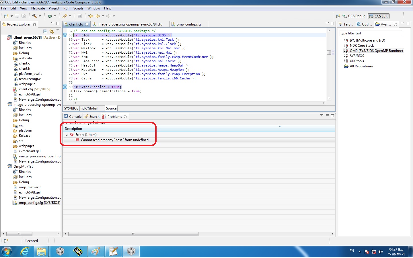

Next I would add OpenMP to it so I added OpenMP in RTSC package and copied the config script of "helloworld_omp" file to config script of my project(client). It makes one error like below.
what should I do? How can I add OpenMP to my project and modify the config script file?
best regards

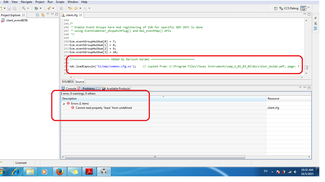

    Can you please attach the modified *.cfg file here.
  • Hi Titusrathinaraj
    I added the file.(at line 253 I copied the lines from configuration file of OpenMP "helloworld" example).
    I should mentioned I want load may program on core_0 but ran on all cores like "image_process_omp" demo project.
     * client.cfg

    // ==================== New Parameter That Added from hello world omp project (omp_config.cfg) ==================================
    // allocate out of this shared region heap after IPC has been started.
    var SharedRegion = xdc.useModule('ti.sdo.ipc.SharedRegion');
    // Configure HeapOMP for the shared memory heap
    // HeapOMP created in ti/omp/common.cfg.xs
    var HeapOMP = xdc.useModule('ti.omp.utils.HeapOMP');
    HeapOMP.sharedRegionId = 2;
    HeapOMP.localHeapSize  = 0x20000;
    HeapOMP.sharedHeapSize = 0x1000000;
    // Specify the Shared Region
    SharedRegion.setEntryMeta( HeapOMP.sharedRegionId,
                                {   base: 0x90000000,
                                    len:  HeapOMP.sharedHeapSize,
                                    ownerProcId: 0,
                                    cacheEnable: true,
                                    createHeap: true,
                                    isValid: true,
    /* load the common configuration file */
    xdc.loadCapsule('ti/omp/common.cfg.xs');
    var System   = xdc.useModule('xdc.runtime.System');
    System.extendedFormats = "%$S";
    var OpenMP = xdc.useModule('ti.omp.utils.OpenMP');
    OpenMP.setNumProcessors(4);
    OpenMP.autoDnldCore = false;                          // add this line

  • Hi Garrett
    I didn't add "pragma" yet, as I mentioned I enabled IPC and OMP in client project like below:
    I enabled OMP support check mark in client project too like below:
    Next I pasted "xdc.loadCapsule('ti/omp/common.cfg.xs');"  from  " C:\Program Files\Texas Instruments\omp_1_01_03_02\docs\User_Guide.pdf " at page 7 to client.cfg.
    After that an error occurred like below:
    I uploaded my build log below:

  • Hi Dariush,
    In addition to those modification you have made, you also need to change RTSC platform from ti.platforms.evm6678 to ti.omp.examples.platforms.evm6678 for the ndk client_evmc6678l project if you want to enable OpenMP. The ti/omp/common.cfg.xs is applicable to OpenMP RTSC platform configuration only. To switch the RTSC platform, go to
    Project->Properties->CCS General->RTSC->Platforms (ti.platforms.evm6678 -> ti.omp.examples.platforms.evm6678)
    Again, I highly recommend you follow the steps described at the wiki page processors.wiki.ti.com/.../Porting_OpenMP_2.x_to_KeyStone_1 to upgrade OpenMP to runtime 2.0, and refer to the user guide at ti\openmp_dsp_2_01_16_03\docs\ to build your OpenMP application.
    Garrett
  • Hi Garrett
    I applied your guidance like below:
    But I saw an error like below:
    I think the problem related to platform but I don't know how to solve it!! Did you test it yourself? what should I do? please, help me.
    Best Regards
