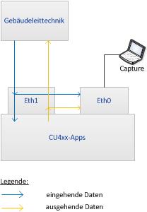

cpsw dual emac configuration - change to: eth0 is copy of eth1 data
Other Parts Discussed in Thread: AM3352
Hi All,
as per
"processors.wiki.ti.com/index.php/AM335x_CPSW_%28Ethernet%29_Driver%27s_Guide#Bringing_Up_interfaces"
we are using the two ethernet ports of the AM3352 as two independent ports in "dual emac" mode. It is working well and the device tree looks like that:
&mac {
    dual_emac = <1>;
    status = "okay";
&cpsw_emac0 {
    dual_emac_res_vlan = <1>;
&cpsw_emac1 {
    dual_emac_res_vlan = <2>;
The Linux image is based on Yocto YP Core - Dizzy (1.7.1).
For diagnostic purposes we would temporarily like to change the configuration in such a way so that the eth0 port is just a copy of the data on eth1.
Is that possible? Can it be done via device tree overlay or some sysfs configuration of the cpsw driver?
Any hints that you would be able to give us are highly appreciated.
