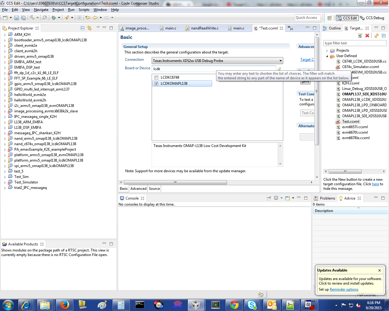

ok so I am following this guide,
I am now trying to add the XDS200 option and select the LCDK OMAPL138 device to mcsdk.ccxml file but its NOT in the list of devices.
the dialog box hints that I can download extra devices ? but how ? download what exactly ??
I don't get a connection with the XD200 jtag , only this error;

Screen grab of no LCDK-L138 in list.

  • Hi Ben,
    Now to work out how to upload it to the LCDK board and run it from CSS?
    For this, you have to create target configuration for your board and emulator.
    Which CCS version are you using ?
    I'm able to create target configuration for XDS2xx emulator with OMAPL138 LCDK board on CCSv5.5 and CCSv6.1 (latest CCS IDEs).
    Did you install the all emulation drivers and Single core supported devices when you install CCS ?

    I downloaded CCS 5.5 again and installed everything !! this time it worked. I must have installed the wrong CPU support in the first place. I'm now able to select the lcdkomapL138 and create the mcsdk.ccxml file with the correct profile. I'm not convinced the XDS200 is connecting correctly since i still have error on test connection. I will post again under a new post 'XDS200' if that's the case.
