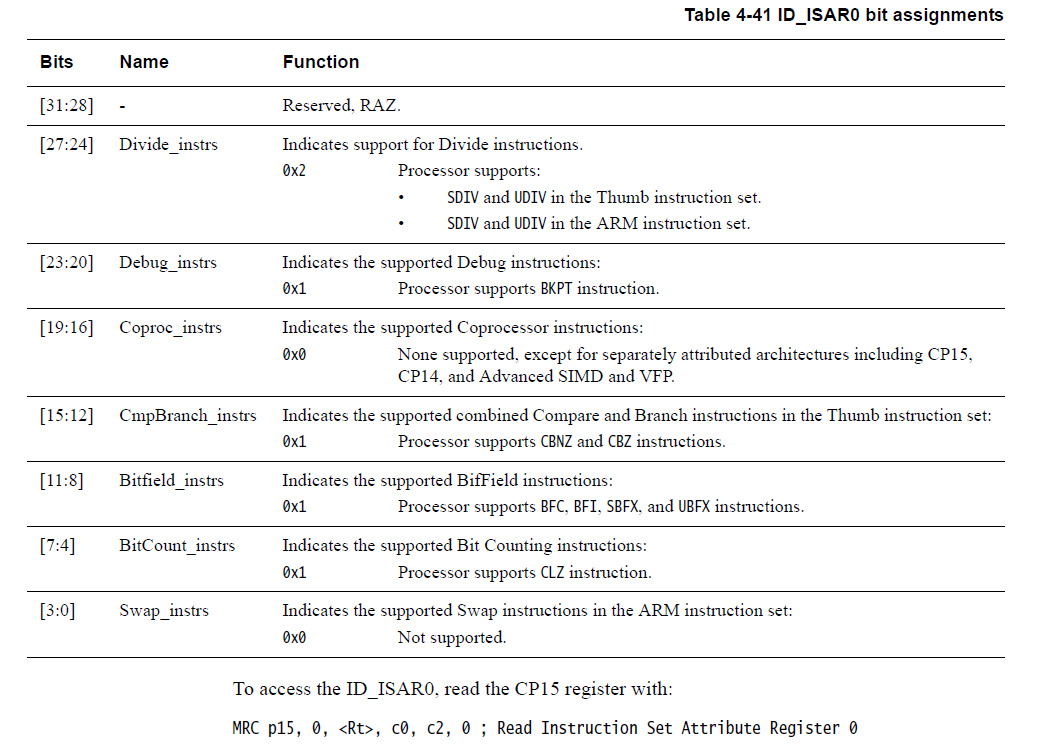

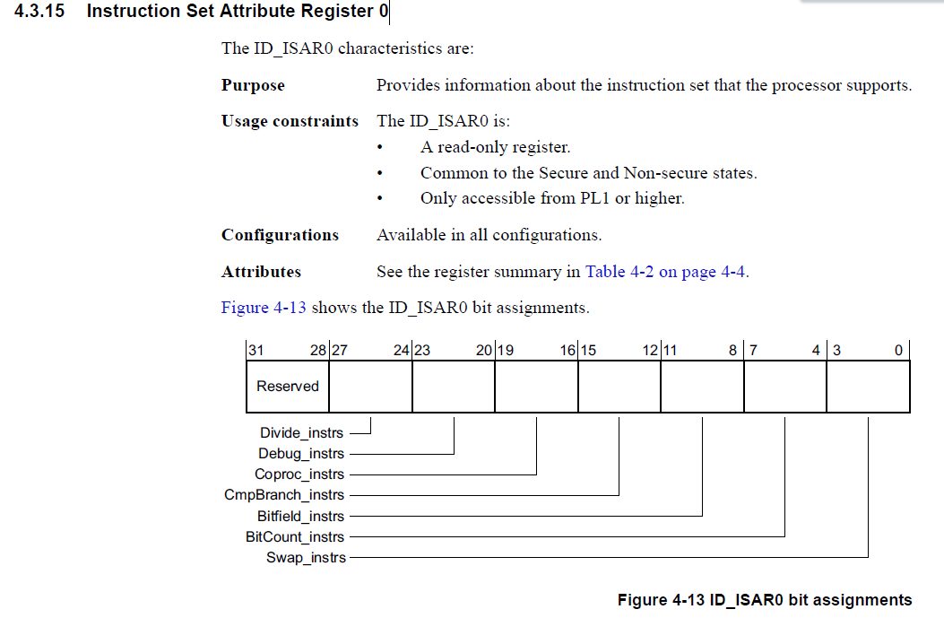

  • Hi Michi,
    I have referred ARM Cortex-A15 MPCore Processor Technical Reference Manual (ARM) and it says it has support to SDIV/UDIV instructions by H/W.
    You can get the status by reading the "Instruction Set Attribute Register 0" ID_ISAR0 (Read-Only Reg) and reset value defined as 0x02101110.
    Thank you.
