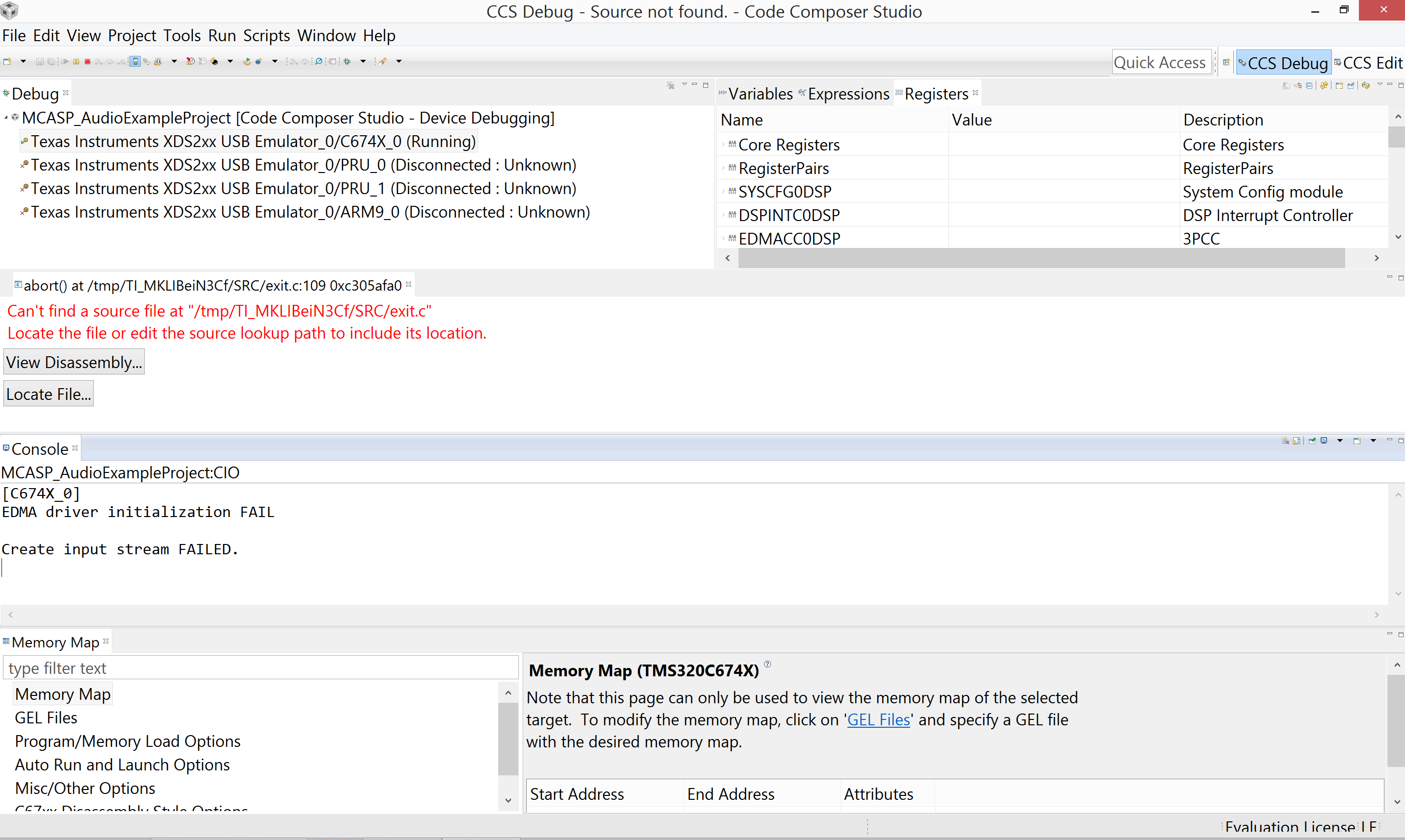

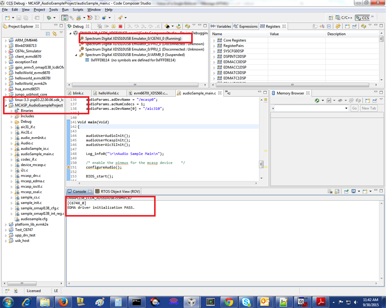

running McASP code from pdk CCS6 , XDS200, lcdk omap-L138
Other Parts Discussed in Thread: OMAPL138, OMAP-L138
hi,
I built the code here C:\ti\pdk_OMAPL138_1_01_00_02\packages\ti\drv\exampleProjects\MCASP_AudioExampleProject
in CC6 with the bios_6_35_01_29 as the debugger requested.
The project builds but I'm not sure it can run. I get no pass through audio and the following error in the console.
[C674X_0]
EDMA driver initialization FAIL
Create input stream FAILED.

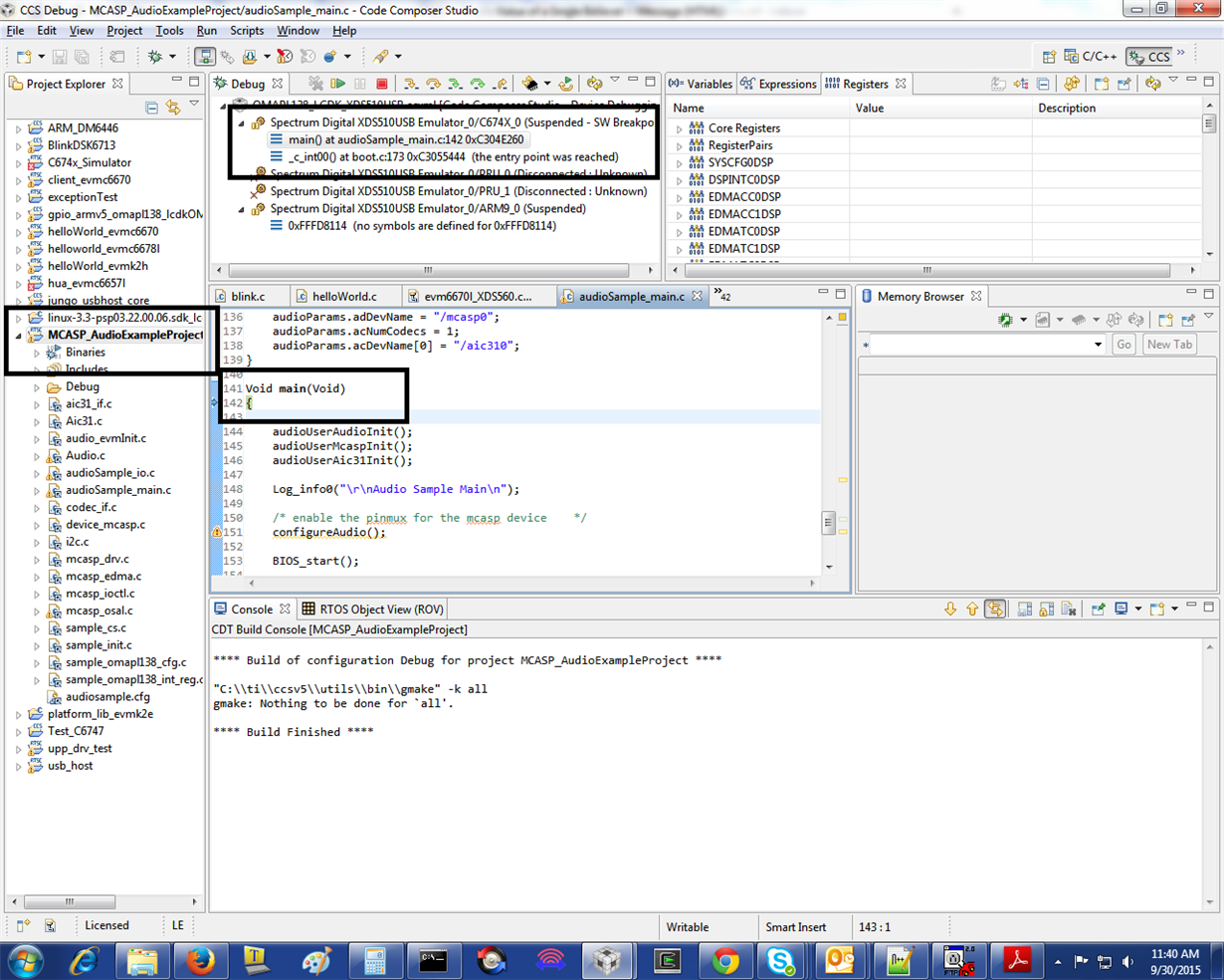

I tried changing the setting in targetConfigs to lcdk OMAP-L138 and XDS200 usb jtag debugger.
I also tried adding my own config file mcdsk.ccxml and selected the correct 0MAP-L138 / XDS200
I get same error either way.
Is there a config I need to edit for EDMA driver ?
I attached a screen shot of the debug window.

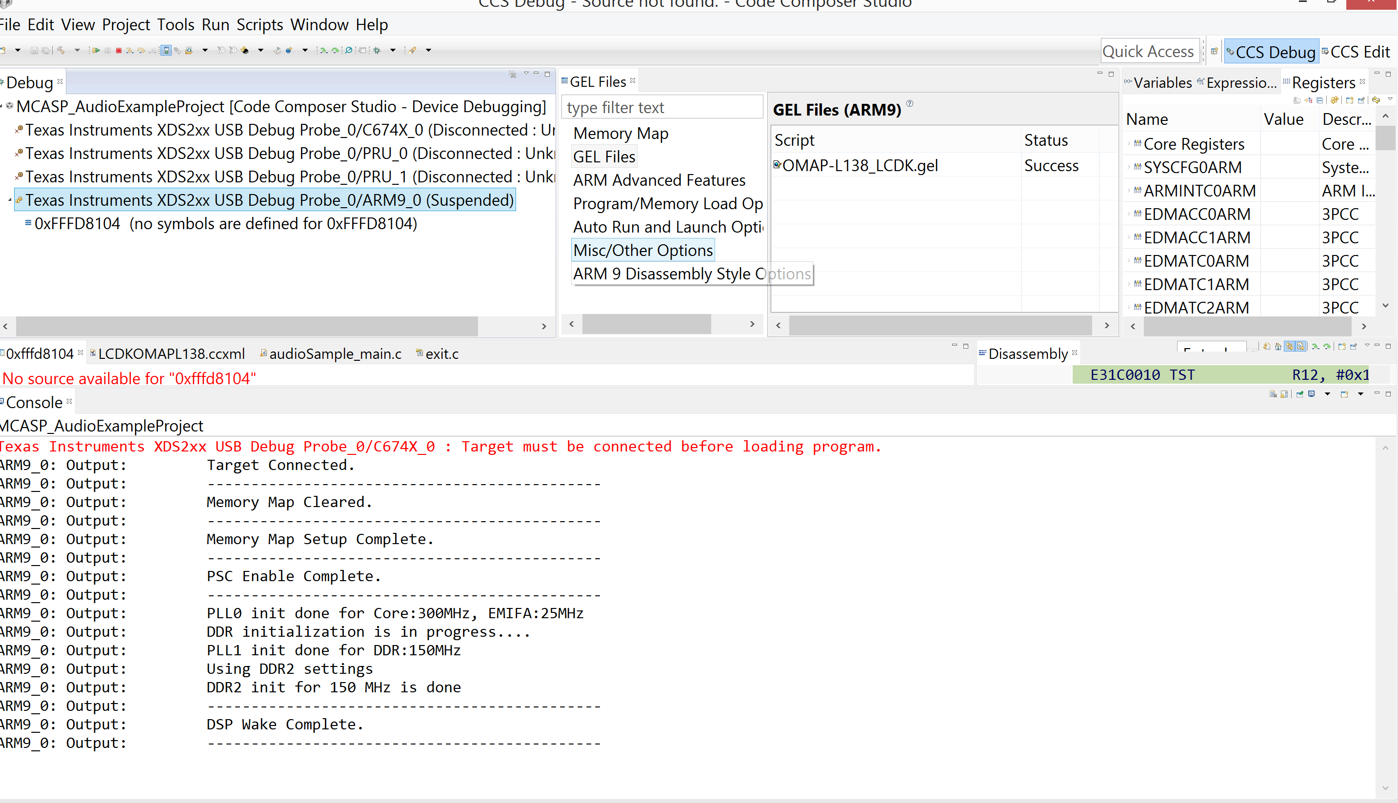

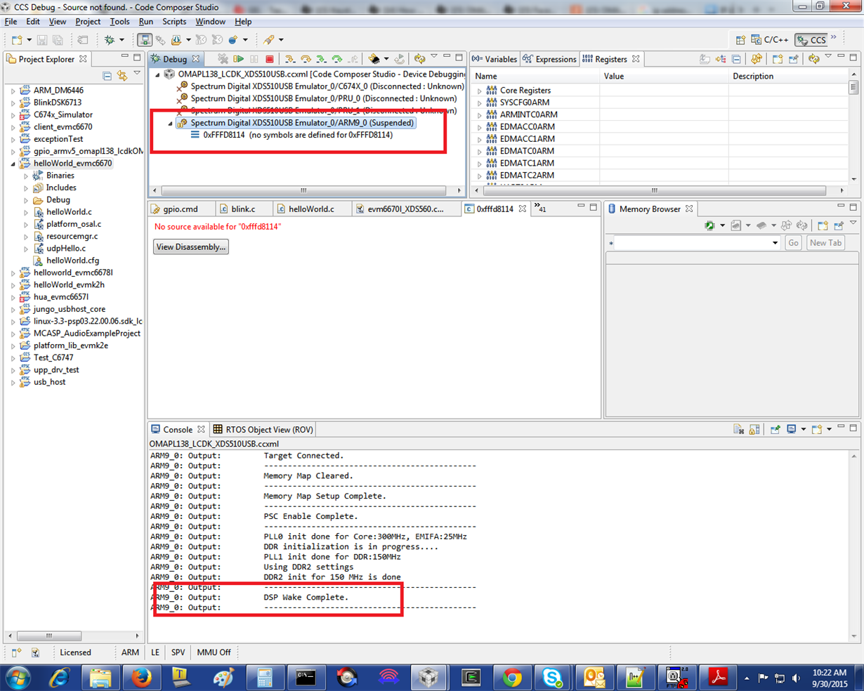

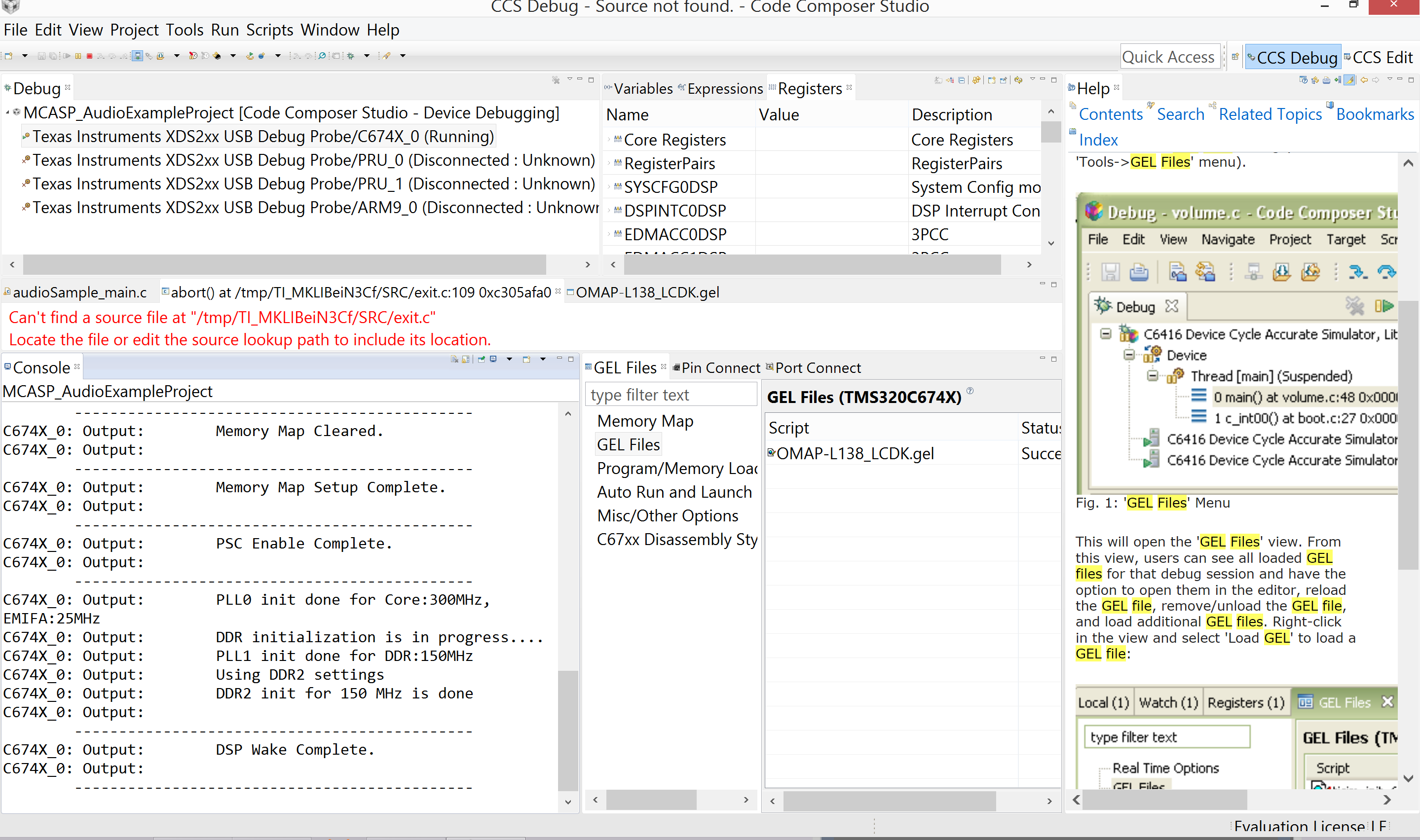

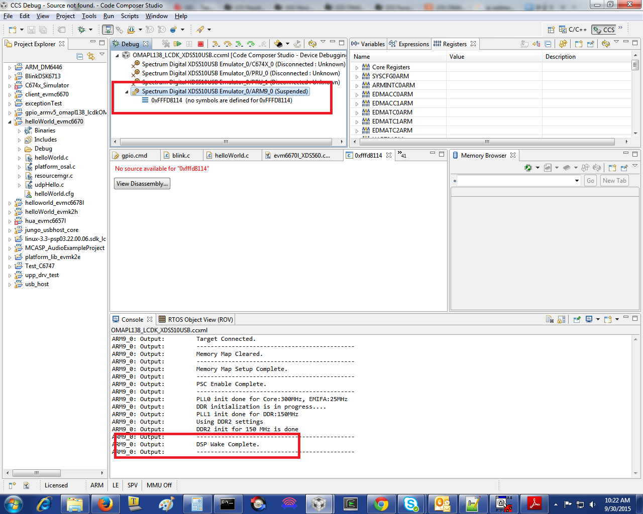

  • Hi Ben,
    Did you initialize the board through gel file ?
    From your screen shot, you didn't connect ARM at all but you should do.
    OMAPL138 is ARM boot device i.e ARM will wake up first and DSP is in reset state then you have to connect DSP to wakeup.
    So, please connect ARM core first, it will call the gel file and initialize the board and then connect DSP, after that you can any example on DSP core.

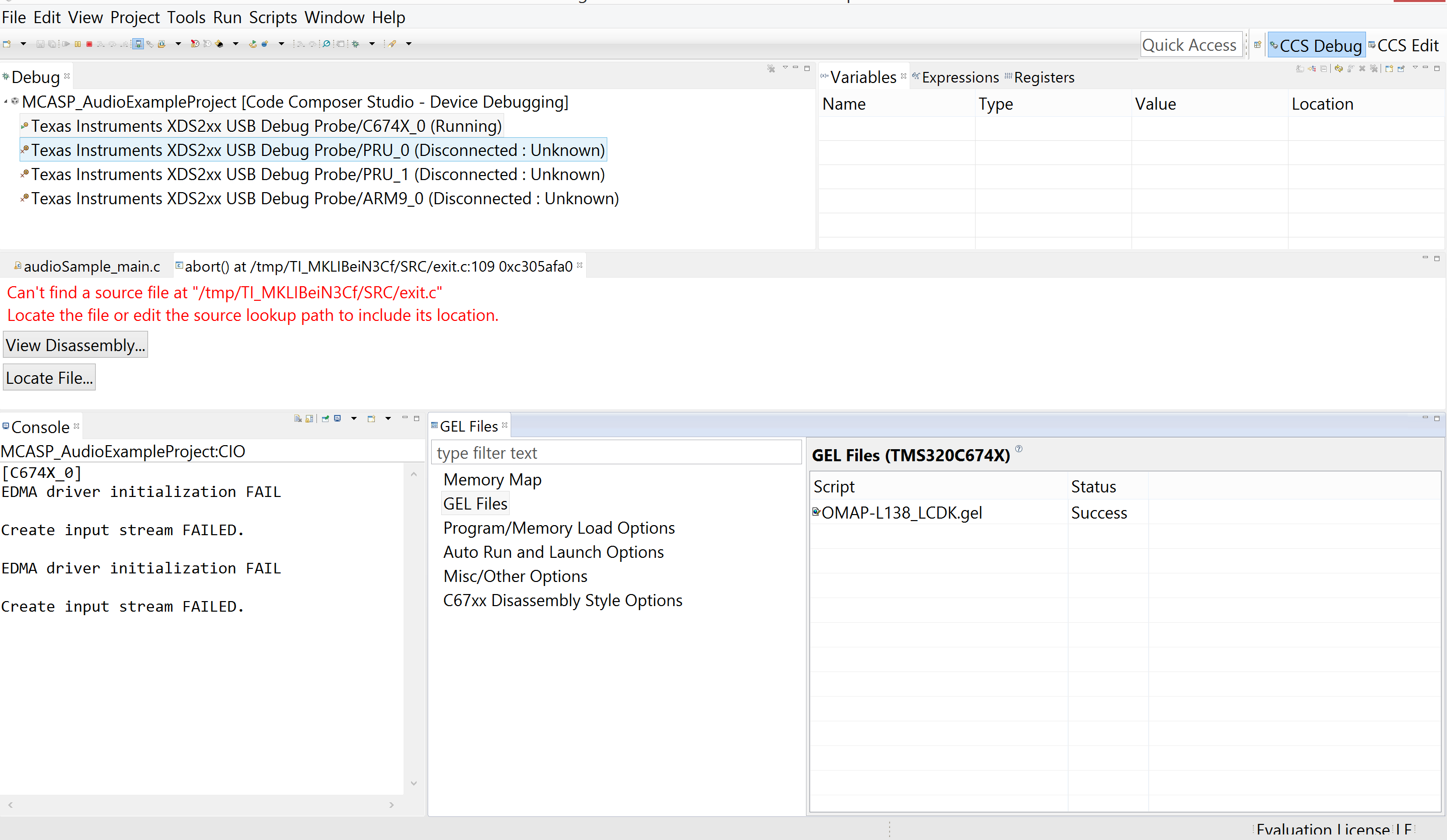

  • Hi, I have no Gel files in GEL view. which Gel file should I add?
    I thought the ARM was booting linux from MicroSD card. Is this wrong?
    What does the GEL file instruct the ARM to DO? the help menu in CSS doesn't give me any clues...
    [EDIT]  I have loaded the gel file, but still I get errors and plenty of XDS200 crashes..
    how do I boot the ARM first ? then DSP ?
    thanks, ben
  • Hi Ben,
    Please refer to the following TI wiki page.
    You would get the logs on CCS console when you connect ARM core, and also you could see the "DSP wake up complete"
  • Hi , I have something similar on console but no audio output. I thought this McASP example should pass audio from input to output?
    thanks, ben

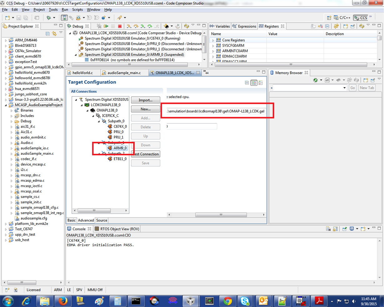

  • Hi Ben,
    I'm able to run the McASP example code and able to hear audio output on OMAPL138 LCDK board.
    You have to gel file for ARM core and not for DSP.
    Connect ARM core first with gel file then connect DSP core and load the McASP code.
    PS: Connect audio source input to top of J19 connector and connect Ear phone to the down port of J19 audio connector.
  • Hi, I'm pointing to the same gel file there. no audio.
    when I click test connection in the target configuration window i get this error.

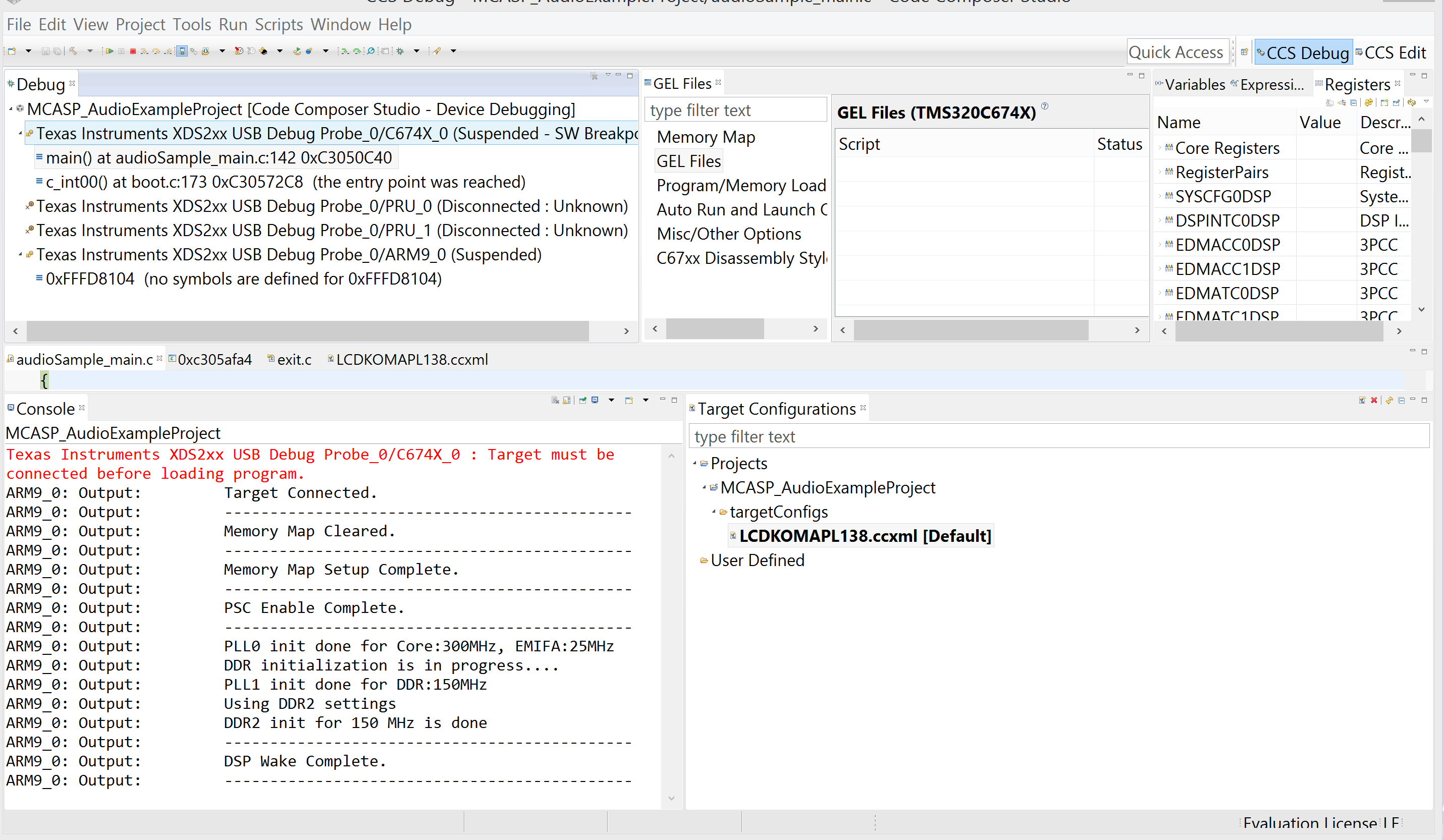

  • Hi Ben,
    C674X_0: Output: Target Connected.
    C674X_0: Output: ---------------------------------------------
    C674X_0: Output: Memory Map Cleared.
    C674X_0: Output: Memory Map Setup Complete.
    Still you are not connecting ARM first and DSP next.
    Your logs seems to be you are connecting DSP first and calling gel file through DSP core.
    Please read my answers carefully and check out the screen shots & compare with yours.
    Edited:
    If you check output of mine, you see that executed on ARM.
    Also I would like to suggest, set boot mode to UART boot mode and try.
    SW1 ( 0:1:0:1 -> 1:2:3:4 )
  • Hi SW1 ( 0:1:0:1 ) is set. Presumably to boot from flash.
    I only have 1 GEL file associated ( with ARM ). when I connect to target ( ARM ) manually the Arm start messages appear in console.
    Then I cannot load program into the DSP core. The option is greyed out.
    If I load the Main() code fist the DSP starts first.
    I have excluded TargetsConfig from the build as I don't see it your list. The entry point address is different in your code, are you selecting that somehow ?
    sorry, I am a beginner at CCS and OMAP. Can you be more specific about what I have to do in order to;
    A connect target ( start ARM core first )
    B Load the program code into the DSP core
    C connect target ( start DSP core )
    Why is the example McASP code not ready just to be built and executed ? It is a demo ? am I missing something completely obvious here? I read the GEL documentation but I cannot see how to design the GEL file to sequence the cores correctly for the DEMO ?
    thanks,
    BEN
    This boot mode is for UART boot mode.
    After connecting the ARM core and got console messages on CCS console then select DSP core, again give connect target DSP (right click) , after that try to load the DSP app on DSP core.
    Don't try to load with out connecting DSP core.
  • I already tried that, I here a click from speakers and it crashes when I hit RESUME after loading code to DSP core as in screen grab.
    is there a correct way to launch code ? is there something with UART I need to set in the XDS200 ?

  • I have a lot of warnings at the compile stage
    37 warnings of #225-D: function declared implicitly
    perhaps there is a bug in the way the Bios works in the CCS 6.11? I thought I installed the correct version of bios to suite
    the example, bios_6_35_01_29
  • here's the build messages from console.. not sure where the build logs are written too..

    I found your problem.
    You build the project with "legacy COFF" output format but you should compile the project with "EABI (ELF)" format.
    Please change it to EABI format and rebuild the project.
    CCS properties -> CCS General -> Output format -> eabi (ELF)
  • wow , thanks !! that fixed it... out of interest, was the old compiler settings loaded by the PDK package ? or its just my mistake ?
    now I can finally get on and learn how to mix audio in DSP and maybe even control it from linux on the Arm..
    I also couldn't figure out how to stop the gel file loading in the DSP debugger settings , have to manually remove it each time.. anyway I will work that one out myself !!
