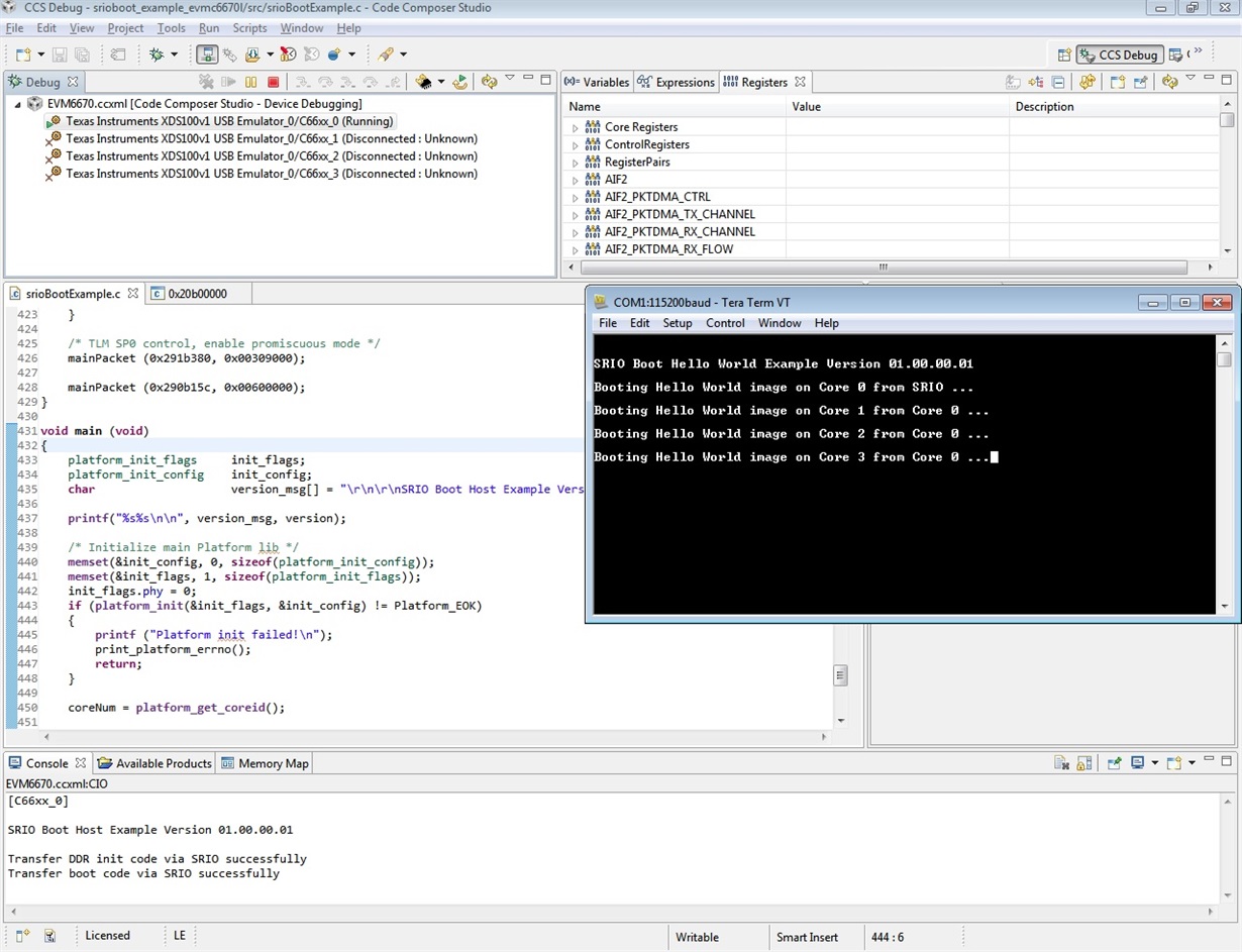

    The SRIO boot example is working on my setup(C6678). I have followed the below steps to test the example on my setup:
    1. Set the both EVM boot mode dip switch setting as ROM SRIO boot mode.
    2. Insert the Two EVM’s to the AMC slot of the breakout card(CI2EVMBOC).
    3. Connect the booting EVM COM1 to the PC’s serial port using a RS-232 cable and connect the JTAG emulator on the Host EVM.
    4. Power on both EVM’s
    5. Open Tera Terminal connection, set the baud rate to 115200 bps, data 8-bit, parity none, stop 1-bit, and flow control none.
    6. Connect the Host EVM using CCS, then load and run the srioboot_example_evm66xxl.out
    see below screen shot for CCS console and Tera Term log:

    The SRIO boot example is working on C6670 setup. I have followed the below steps to test the example on my setup:
