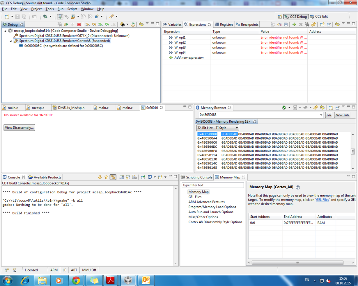

mcasp loopback test dm814x :no output
hello guys
I am trying to implement simply an internal loopback test on mcasp dm814x using code composer ccs5 .Although registers are configured properly but still it shows ambiguites nd test jumps to nowhere stating "no source available for 0x20010. I have tried many times to pinpoint the fault but  i think few bits of GBLCTL are not configured.Though i took this configuration from Mistral test codes and using gel file for initializing clocks but its not going anywhere except "no source available "i am pasting test code here.kindly help me in this regards.

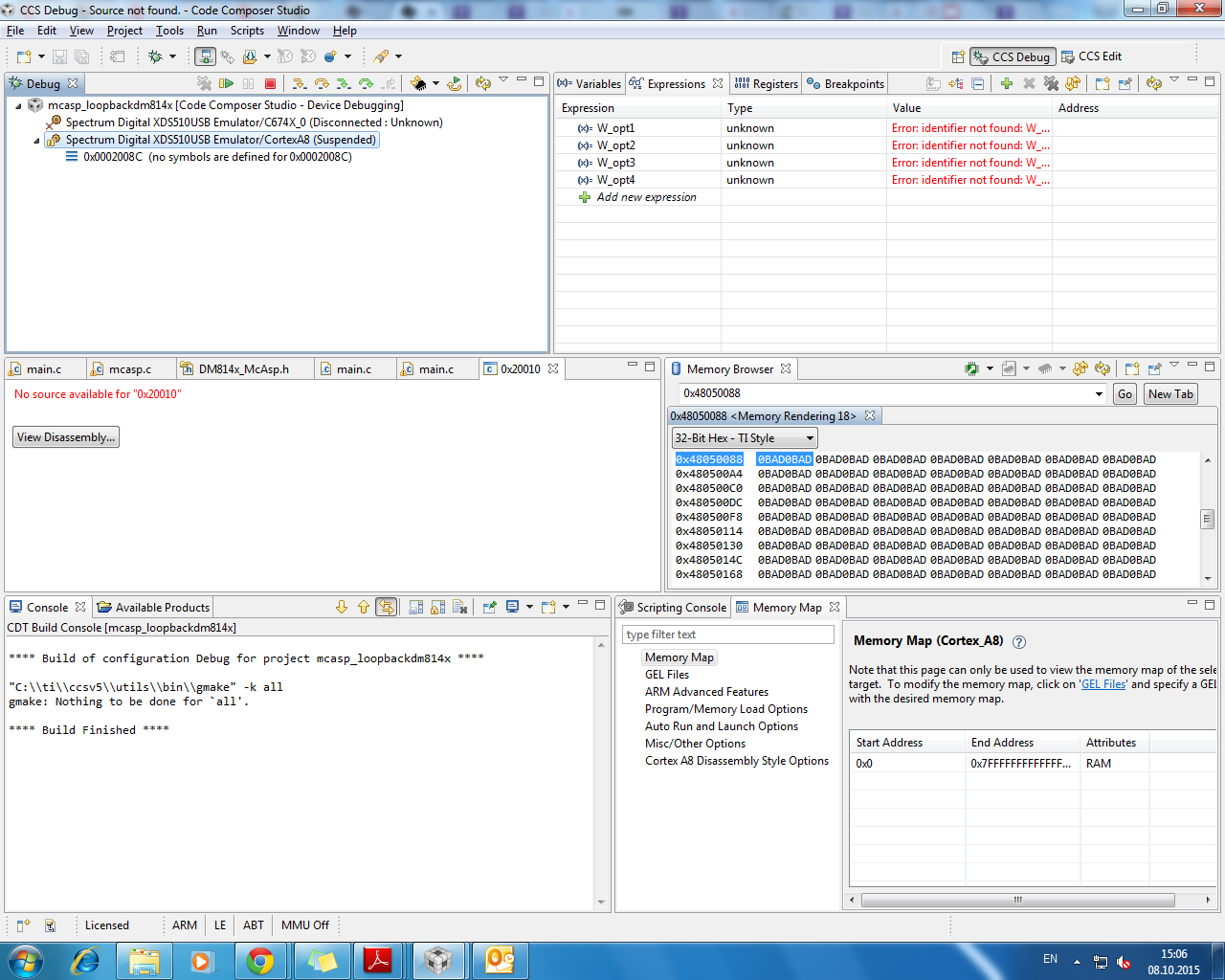

  • Tariq,
    Can you provide me a screen shot (print screen) of this error message?
    BR
    Pavel

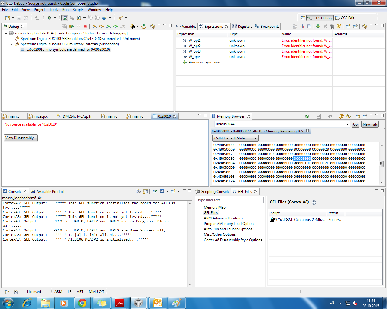

  • two days ago registers upto amute reg are configured properly and showing the values in registers as programmed accordingly but after that no value though if i run this function "void init_MCASP_global(DM814x_MCASP_REGS stMcAspRegs) " it configured upto "TX" side while for /* Starting sections of the McASP*/ is not showing anything and besides program goes into halt state,no matter what u do,stating the error which i uploaded above in snapshot
  • Tariq,
    Are you using GEL file only, or you have GEL file + out file?
    BR
    Pavel
  • i am using out + gel file though using only one module of gel file to initialize the aic3106 baseboard setup as memory content is not visible for mcasp region without the initialization through gel file...
  • Let me clarify the below:
    When you load first the GEL file, everything seems to work fine, but after that when loading out file, you get this problem?
    BR
    Pavel

  • Muhammad Tariq said:
    yes i was thinking maybe the address it is trying to find doesnt exist actually thats why it states "no source available".and thats why i am not getting any results
    The "no source available" warning message is not the reason you are not getting any results.
    why i am not getting any value on required registers
    What values do you need? In which registers you need these values?
    BR
    Pavel
  • i am not getting any values or more specific to be desired ones on following registers :
    TXBUF0 0x48050200 to TXBUF15 0x4805023C ,RBUF0 0x48050280 to RBUF15 0x480502BC and GBLCTL register 0x48050044.
    if u see in my test code , i have written some some values on TXBUFi(where as i =0 to 15) and reading them back on RBUFi after initialization of MCASP modules and these are the registers where i am not getting values.
    regards
  • Tariq,
    As McASP2 has only 4 serializers (0 to 3), thus there are only 4 TXBUF and RXBUF (0 to 3), not 16 (0 to 15). Can you try modify your code to 4 TXBUF/RXBUF (0 to 3) only, will be there any result?
    Can you try also access TXBUF/RXBUF from the data port (0x46800000), not through the cfg port (0x48050000), will be there any result?

  • i have done modifications as you said with 4 serializers along with data port rather than cfg port but still no result.
    secondly according to dm814x data sheet it states register addresses of 16serializers of all 6 MCASP modules and as well in TRM with 16serializers block diagram in loopback modes section 16.2.8.5 though there is mentioning of 4 serial data pins in MCASP2,3,4 and 5.Can you clear this confusion too plz?
    For using the CFG port (0x48050000), make sure XFMT[3] XBUSEL = 1
    The TRM is generic. DM814x McASP2 has 4 serializers (0 to 3), thus 4 data pins (AXR[3:0]), 4 XRSRCTL, 4 TXBUF, 4 RXBUF
