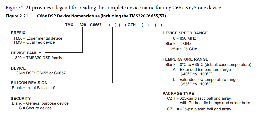

  • Ensure that the part selected is within the temperature limits. Please refer the PACKAGE OPTION ADDENDUM and device nomenclature from the data manual.
    Thank you.
    Thanks for the info.we are using the default case temperature (0 to 85C). is it possible to measure the temperature by using any of DSP registers?Then it is easy for me to input this value to the log file, then analyse at which temperature it is failing.
