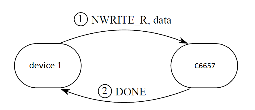

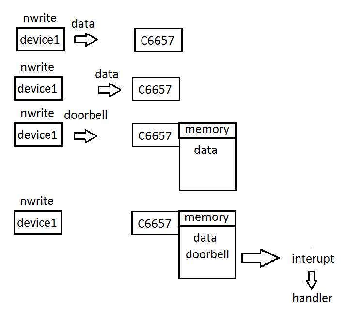

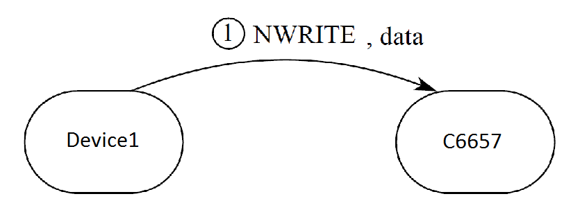

  • an external device interface SRIO sends data to the С6657
    above my code for s6657 where turn SRIO
    good work! data receiving С6657
    how to connect the interrupt when the memory is full С6657?
    maybe so?
    SRIO_LSU_TRANSFER lsuTransfer;
    lsuTransfer.rapidIOMSB = 0;//(Uint32) pOperation->pExternalAddressMSB;
    lsuTransfer.rapidIOLSB = 0;//(Uint32) pOperation->pExternalAddressLSB;
    lsuTransfer.dspAddress = 0x0c000000;//(Uint32) pOperation->pInternalAddress;
    lsuTransfer.bytecount = 256;//pOperation->Size;
    lsuTransfer.doorbellValid = (pOperation->DoorbellRegIndex != -1);
    lsuTransfer.intrRequest = 1;
    lsuTransfer.supInt = 0;
    lsuTransfer.xambs = 0;
    lsuTransfer.priority = ((UInt8) pOperation->Priority) << 1;
    lsuTransfer.outPortID = 1;//pOperation->PortIndex;
    lsuTransfer.idSize = 0;
    lsuTransfer.srcIDMap = 0;
    lsuTransfer.dstID = pOperation->TargetId;
    lsuTransfer.ttype = 4;//(UInt8) pOperation->TransactionType;
    lsuTransfer.ftype = 2;//(UInt8) pOperation->OperationType;
    lsuTransfer.hopCount = 0;
    lsuTransfer.doorbellInfo = pOperation->DoorbellRegBits;
    CSL_SRIO_SetLSUTransfer(m_Handle, portIndex, &lsuTransfer);
    but does not work
    For my understanding, you are working on devcie2 side and your device2 only receive the data from device1 via SRIO. Is it correct?
    Are you trying to configure the interrupt on device2 side, the device2 will receive the interrupt after receive the data from device1 or device2 memory is full.
  • Hi
    1)For my understanding, you are working on devcie2 side and your device2 only receive the data from device1 via SRIO.
    - Yes ( This interaction is expressed in a direct memory access address of another device )
    2) Are you trying to configure the interrupt on device2 side, the device2 will receive the interrupt after receive the data from device1 or device2 memory is full. (or device2 memory is full? I mean when the memory (device2) is written a certain number of bytes)
    - essentially the same thing
  • why do not interrupt occurs when answering DONE ( I am facing a problem with the event handler to SRIO doorbell no interrupt)

    RX hardware mechanism in the peripheral that will make sure that any data transfer arrives in memory before a DOORBELL interrupt is fired. So for directIO packet types like SWRITE, where the complete transfer can be any number of packets, as long as the SWRITE packets and DOORBELL are sent on the same priority (and by the same LSU if the DSP is the TX device) such that there is no reordering, the payloads will have landed in memory before the interrupt is fired.
    DOORBELLs can be used for generic interrupt purposes. Since they are generic and their use is defined by the application, there is no reference to MAU or any specific data transfer. The use of DOORBELLs for the interrupt in your scenario is the best way to handle it. If the length of transfer is not agreed upon by TX and RX device in the system and the RX device needs to determine the total payload size, then you can do things such as send the total byte count in the payload of the message (first word for example, like a customer header), or if there are finite number of payload sizes, you could use the particular DOORBELL interrupt source to indicate (For example DOORBELL bit 1= 256B tranfer interrupt).
  • Thanks you
    I will try to adjust the interrupt on the С6657  for this circuit
    glist
  • I read all datasheet. Unfortunately for my case (diagram above) does not describe how to configure Interrupt C6657.
    the C6657 is processing data, how the C6657 recognizes that the new data came from the device1
    Prompt me please
    For enabling transfer completion interrupts for DIO transactions (NWRITE, NWRITE_R and NREAD). The following bit needs to be set, while setting up the LSU registers:
    LSU_REG4.Interrupt Req = '1'
    A better approach here is to configure the LSU registers to automatically send a doorbell to the external PE on the completion of the DIO transaction and setting up a transfer completion interrupt for the same. This can be done by setting up the following:
    LSU_REG3.Drbll_val = '1'
    LSU_REG5.Drbll Info = "Doorbell info" (The doorbell interrupt expected by the external PE)
    For more information, please refer to section 2.3.2 "Direct I/O Operation" in the SRIO users guide. Doorbell interrupt is implemented on attached SRIO example project(in 2DSP test mode), take a look at this example to understand the interrupt configuration. Also refer the attached SRIO programming guide.

  • Hi
    I want to clarify just in case
    I do not want to adjust the interrupt on the device1
    I use only NWRITE on device1.
    on C6657 adjust LSU_REG4.Interrupt Req = '1'
    and on C6657 srio will generate an interrupt each time the new data comes from the device1 ?
  • LSU_REG4.Interrupt Req = '1'  Configure outgoing port ID, Priority and other RIO parameters. */ This setting device1
    I use on device1 only NWRITE
    register LSU_REG4.Interrupt Req = '1'
     Configure outgoing an interrupt at the end of transmission for Device1
    I need to interrupt an incoming с6657
    help me nucu
  • how to adjust the interrupt data is received
    C6657 srio will not generate/get an interrupt each time the new data comes from the device1. The transfer control interrupt and doorbell interrupts are not support your requirement. Better to use the EDMA for SRIO transfer.
