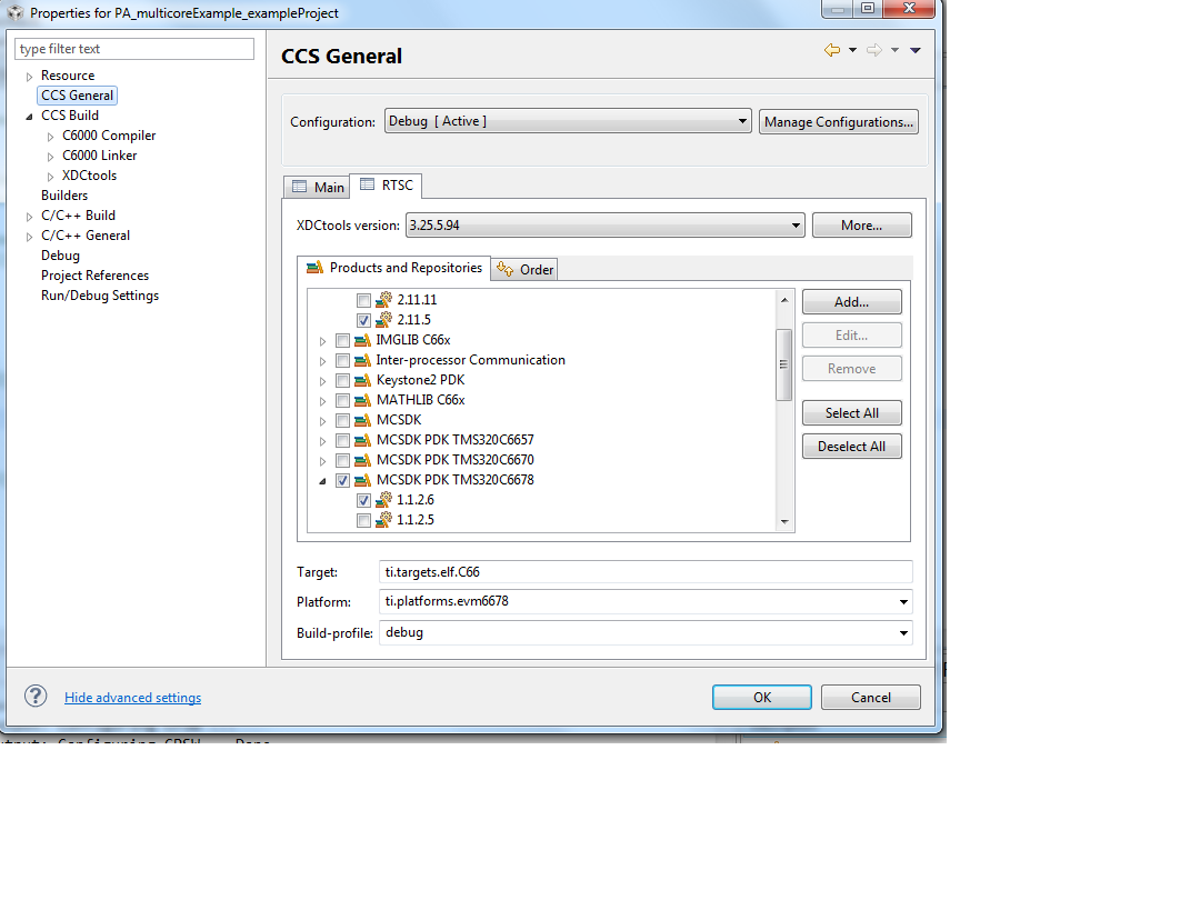

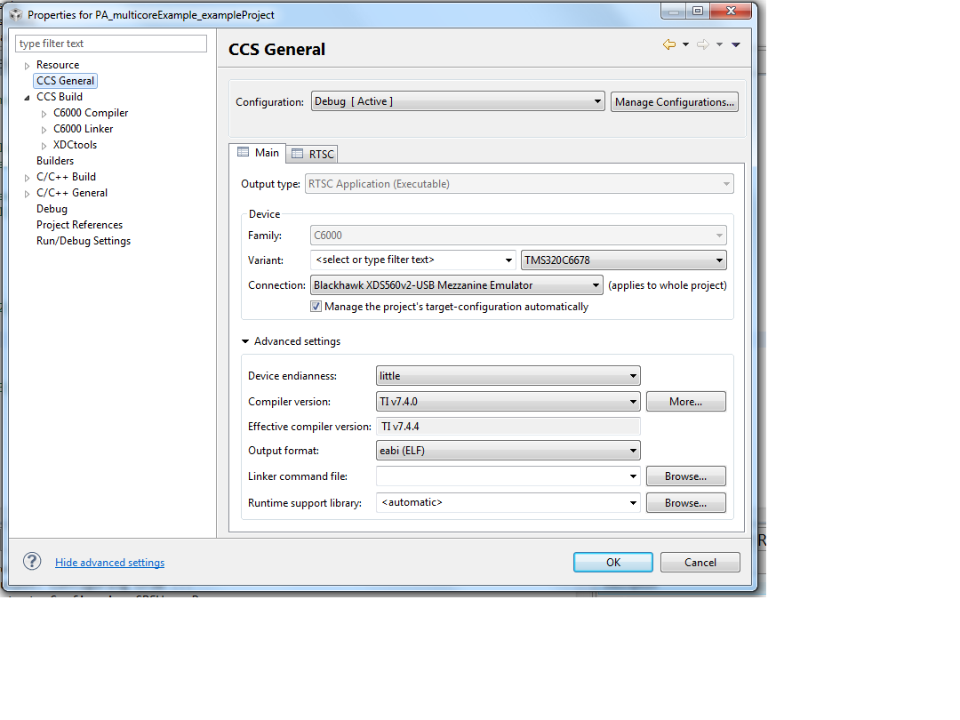

I use TMS320C6678 with Blackhawk XDS560v2 - USB Mezzanine Emulator and CCSv5.2 - Windows.
I got a strange error when trying load .out file. This example of a message when I try to load TI example:
C66xx_0: GEL: File: C:\Users\Borovikov_O\garbidge_ntk_workplace\PA_multicoreExample_exampleProject\Debug\PA_multicoreExample_exampleProject.out Does not match the target endianness, not loaded. Check project build options and target configuration file (ccxml).
Project property is:
and
