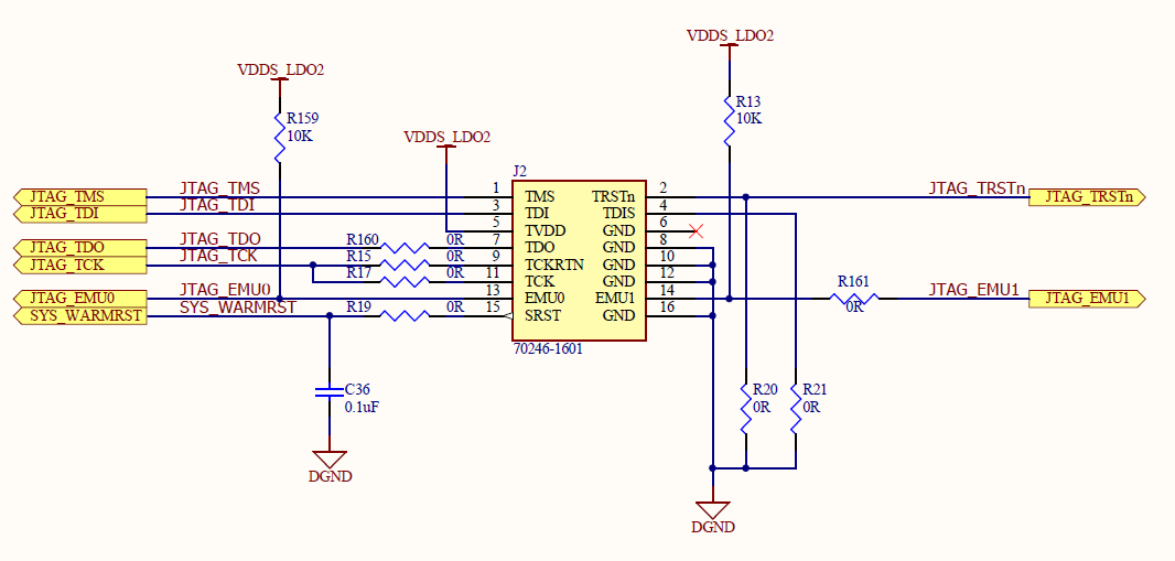

  • Hello Biser,
    We are using Blackhawk XDS100v2 ARM JTAG, AM3358_StarterKit Gel file and CCS version 6.0.1.
    I'm not able to connect the board. I'm getting "error connecting to the target" error-2131.
    Error connecting to the target:
    (Error -2131 @ 0x0)
    Unable to access device register. Reset the device, and retry the operation. If error persists, confirm configuration, power-cycle the board, and/or try more reliable JTAG settings (e.g. lower TCLK).
    (Emulation package 5.1.507.0)
    Jtag test connection is also failing,

  • Can you post the JTAG part of your schematic?
  • Hello Biser,
    PFB Snapshot of the JTAG schematics.
    Thanks and regards,
    Lahari P.
  • Check R20. If it's really 0Ohm the JTAG won't function. Change it to 10kOhm.
  • Thanks for the quick reply Biser.
    I tried connecting 10Kohm to R20. But still I'm facing same error.
    Please let me know if am missing something.
    Kindest regards,
    Lahari P.
  • This doesn't sound good. The XDS100 buffer that drives TRST may have burned. What you can do is check whether the TRST line toggles when you attempt to connect. The other thing is to try with another XDS100, if you have one.
  • Wait a second: You posted that you have a Blackhawk XDS100v2 ARM JTAG, right? Do you have the CTI-14 adapter for it? ARM JTAG connector arrangement is different from the CTI-14 that you have on board. See this wiki for differences: http://processors.wiki.ti.com/index.php/JTAG_Connectors#Pinout
  • Biser,
    TRST line is toggling when we do "test connection". Yes we are using Blackhawk XDS100v2 ARM JTAG.
    We are referring the same link "ARM 20-Pin" column and connected VTref, nTRST,TDI,TDO,TMS,TCK and GND lines.
    Thanks and regards,
    Lahari P.
  • So does it connect now?
  • No.. same error Biser.
    Thanks and Regards,
    Lahari P.
  • No.. Same error Biser.
    Please advise.
    Thanks and regards,
    Lahari P.
  • If your XDS100 has an ARM-20 pinout, this is the adapter to CTI-20 (you can safely ignore pins 15-20 on the CTI-20 side):
    ARM-20_cTI-20_schematic.pdf
    You can also see this wiki for debugging connection problems: http://processors.wiki.ti.com/index.php/Debugging_JTAG_Connectivity_Problems
