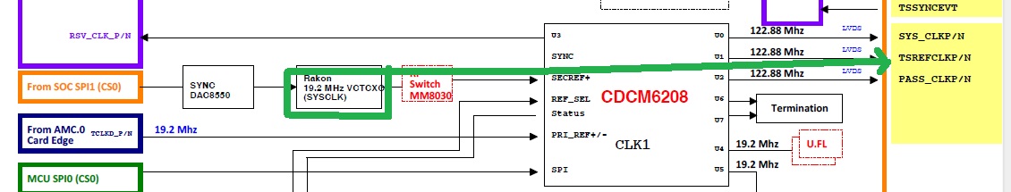

  • But the frequency adjustment is hardware-supported according to EVMK2H schematic, where there is a adjustable clock VCTCXO connected to the pin TSREFCLKP/N as followings:
    And according to 66ak2h14 datasheet, RFTCLK Select Register (CPTS_RFTCLK_SEL) can be set to be TSREFCLK.
    Does it mean: it is supported in hardware, but not supported in the CPTS driver due to using the internal clock as the reference clock?

  • Hi, Rex
    Sorry, I'm a little confused about what you said "The EVM does not have external clock source".  In my opinion, the adjustable clock VCTCXO highlighted in the following picture feeds clock to CDCM6280 which generates frequency-multiplied clock to the pin TSREFCLKP/N as external clock source for CPTS.  Is that correct? Or the pin TSREFCLKP/N is not for CPTS? Or others?
    Xin.
  • Hi, Xin,
    Sorry, I am not a hardware person and this may be out of my area, but I'll try to see if I do an OK job.
    The highlighted component is not what it means external/internal clock. It takes the feed from SPC_SPI1 and you should look beyond SPI. The feed to the SPI before it finally goes to VCTCXO can be from different sources, either an internal clock or some external clock sources. I am not sure if you have the schematics beyond the SOC_SPI1 which shows what gets feeded in to SPI. That will probably explains more clearly. If you don't have that part of the schematics, I will need to involve TI's hardware people.
    Rex
  • Hi, Rex,
    SOC SPI1 is from keystone2 chip and it is used to adjust frequency of the adjustable clock VCTCXO. I suggest you to resort to your hardware engineer.
