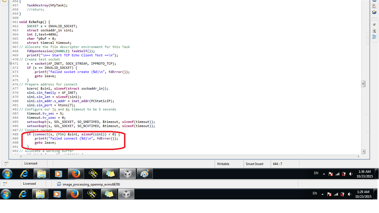

I modified "image_proc_demo". I added TaskCreat() function in OpenNetwork() function and assigned my socket program to it.
My new modified project works correct. I receive data from LAN port by TCP protocol and I don't need the part of code related to web server, mailbox... . But when I comment this parts of code the connect() function doesn't work!! I comment lines 302 to 330 in "mcip_master_main.c" file as below:
What other modifications should I do?

    I appreciate your answer. When I said the connection() function doesn't work I mean the connection function in my TCP socket
    thread but I think you mean the connection function in web sever program.
    As I said at first I make a thread as below:
    I assigned my TCP function to it by name "EchoTcp". After that I want remove webserver. when I comment lines 302 t0 320 in
    "mcip_master_main.c" the connect() function in "EchoTcp" function doesn't work as shown below:
    I find out from your answer that I should define a buffer for my TCP socket connection in "master_main()" function by CfgAddEntry()
    function. Next I can remove lines 302 t0 320 in "mcip_master_main.c" and my connect() function in my TCP socket thread will work.
    Am I thinking right? If the answer is yes, how can I do it?
