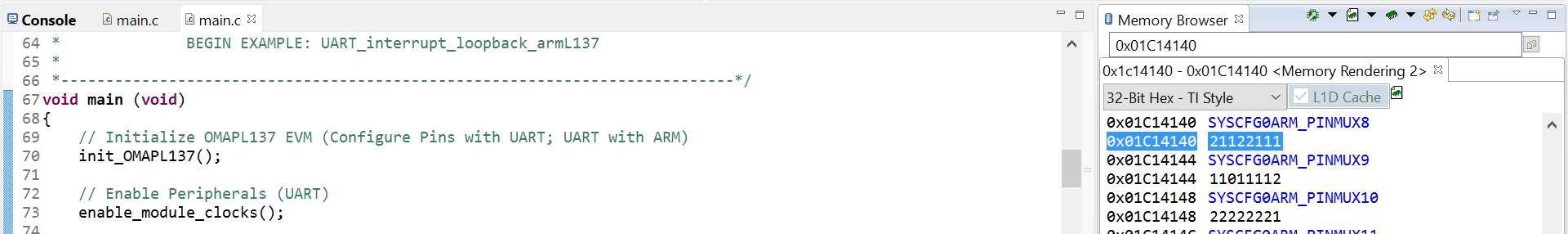

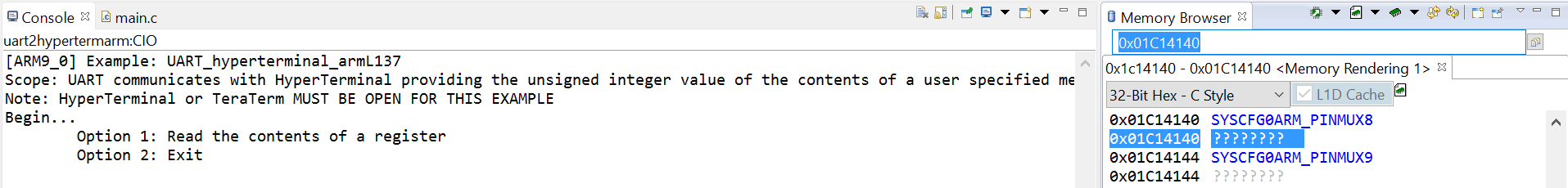

    for some reason I can't put breakpoints inside the function that sets the pinmux.......
    but here are the values in the memory browser, my guess is that I have something wrong.
    if I run the uart loopback example I get the following screen:
    which makes sense, since 31_28 are set to 2 hex and per spruh92b.pdf that is the value for RXD. I also figured out why I was not getting the values in the first screenshot. Once fixed and ran, again, I get the same result as the interrupt_loopback. As you can see PINMUX9 also has 2h in 0-3.
