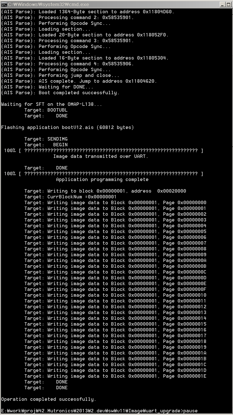

    I rechecked the Boot pages and the boot code is included in pages 0~0x1E(30d) as the following picture which displays the downloading boot code by sfh_OMAP-L138.exe.
    So. there is no not-corrected error in pages 0~30 and my board should boot without problems.
    Please let me know other consideration.
