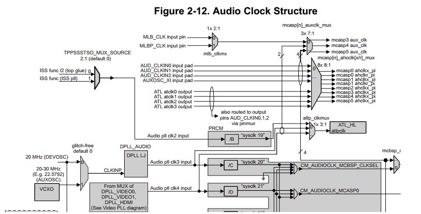

  • Hi Pavel,
    I think the only available path I see is
    osc1_clkin_ck -> audio_dpll_clkin_ck -> audio_dpll_ck -> mcasp4_fck -> McASP3 AHCLKX_OUT -> L5 pin
    and this is what I tried to the in the above trials (which none worked for me).
    I don't see the other path you mentioned:
    osc1_clkin_ck -> mcasp4_fck -> McASP3 AHCLKX_OUT -> L5 pin
    in the picture below:
    Is there any reason why the above trials did not work ?
    Ran

  • Ran,
    It is there:
    AUXOSC_XI -> mcasp3 aux_clk

    Ran Shalit said:
    Are there any additional changes that we need to do except for 0x48140834 register ?
    Yes
    Ran Shalit said:
    I am trying to use the following path:
    As to AUXOSC_XI we are not sure if it means the same as AUXOSC clock (if it is the same, then that path can be used if the first one does not work)
    As we discussed, osc1_clkin_ck corresponds to AUX_CLKIN, while osc1_xi_ck corresponds to AUXOSC_MXI.
    On DM814x TI EVM, we have AUX_CLKIN/osc1_clkin_ck option, which is explained in DM814x datasheet, section 7.4.1.1 Using the Internal Oscillators. While to have AUXOSC_MXI/AUXOSC_XI/osc1_xi_ck option, you board must apply to description in section 7.4.1.2 Using a 1.8V LVCMOS-Compatible Clock Input
    On which of the two options your custom board is designed? AUX_CLKIN/osc1_clkin_ck or AUXOSC_MXI/AUXOSC_XI/osc1_xi_ck? If you copy the EVM design, then you should use AUX_CLKIN/osc1_clkin_ck option. Then your path should be:
    You should set audio_dpll_ck as a parent for mcasp4_fck. By default we have:
    ./osc0_clkin_ck/l3_dpll_clkin_ck/l3_dpll_ck/sysclk4_ck/sysclk5_ck/mlb_ick/mcasp_auxclk_mux0_ck/mcasp4_fck/rate ==> 200000000

  • Ran,
    clkp_mcasp3 = clk_get(NULL,"davinci-mcasp.3");
    This do not look correct. dev_id of this clock is not NULL. Refer to clock framework wiki for more details.
    Ran Shalit said:
    2. setting/reading register 0x481C 62D4h <<-- value is always 0
    Try in u-boot and see if the value will be accepted in linux.

  • Ran,
    We can not be completely sure. I would recommend you to export this clock to the McASP3 AHCLKX ouput pin (setting the AHCLKX divider to 0, thus divide by 1 and HCLKXM=1) and you should measure 2457600Hz with a scope on the McASP3 AHCLKX pin.
    BR
    Pavel
  • Hi Pavel,
    I try to set it in u-boot but the value does not change as I said :
    TI8148_EVM#mw 0x481c62d0 1
    TI8148_EVM#md 0x481c62d0
    481c62d0: 00000000 00000000 00000000 00000000 ................
    BR,
    Ran
  • The correct address is 0x481C52D0
  • Pavel,
    Thank you so much for the magnificent support. It finally works :))
    I now have 2 codecs. I understand that I need to use the perphreal registers....
    Thank you very much!!!
    Ran
