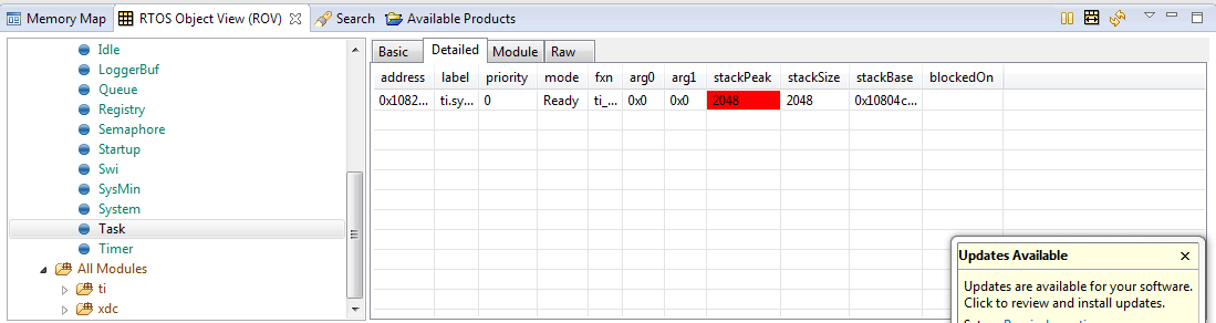

I examined the stack in the ROV, and saw the following:
which lead me to believe that the stack was not big enough, however expanding the BIOS.heapSize still resulted in a stack overflow.  Upon examining the memory at the stackBase location, I saw that the entire stack was cleared to 0x00000000 before the code even executes.  I saw elsewhere on E2E that the stack should be initialized to 0xBEBEBEBE.  While changing the linker file to set the .far section as NOINIT stopped the stack from being cleared to 0, the data there was only garbage and still not 0xBEBEBEBE.
I'm attempting to figure out why the stack isn't being properly initialized as I assume this is the reason behind not being able to create a task.  I've already verified that creating a new task works using the "Typical Project" for SYSBIOS and that the stack is properly initialized so it seems like whatever does the stack initialization isn't running in my code.  I was wondering if anyone could point me to where this init code is located so I can figure out how to get it to run.  I've also attached my .cfg file.2046.app.cfg
  • Keith,
    In your application, you are creating a task with default parameters values (a NULL value is being passed to params).  And the default task stack size for C6674 is 2048. But looks like this stack size is insufficient for the task function "BackgroundTask". Can you increase the task's stack size?

  • Vikram,
    Thanks for your quick response.  I can dial up the taskParams.stackSize to 32,768 and still get the same problem.  The error I am getting seems to indicate that the error is with the SYSBIOS heap being full rather than the Task heap.
  • Keith,
    In SYS/BIOS, heaps are system level only whereas the stacks are both system level and task level. When a Task is dynamically created (i.e. using Task_create()), memory is allocated on the heap for a Task object and the Task stack. So, when you dial up the taskParams.stackSize, a equivalent value should be dialed up on BIOS.heapSize if you are creating the Task dynamically.
