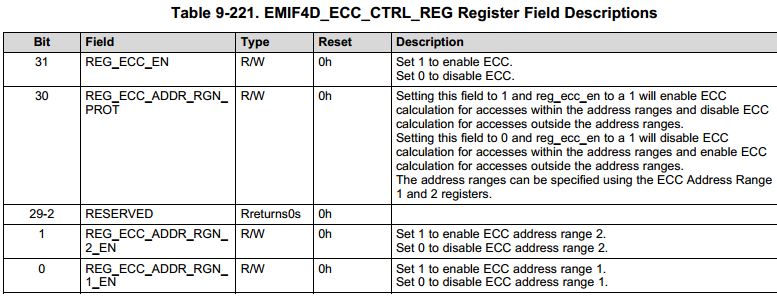

this is My  issue:   How to properly adjust  EMIF ECC
my goal:  detect DDR error
My test :  DDR read/writre in Uboot
My setting:
   EMIF4D_ECC_CTRL  :
enable      REG_ECC_EN /  REG_ECC_ADDR_RGN_PROT / REG_ECC_ADDR_RGN_1_EN / REG_ECC_ADDR_RGN_2_EN
result-----> ECC_ERR_CNT has increased  , and  my DDR read/write test Error
why?
