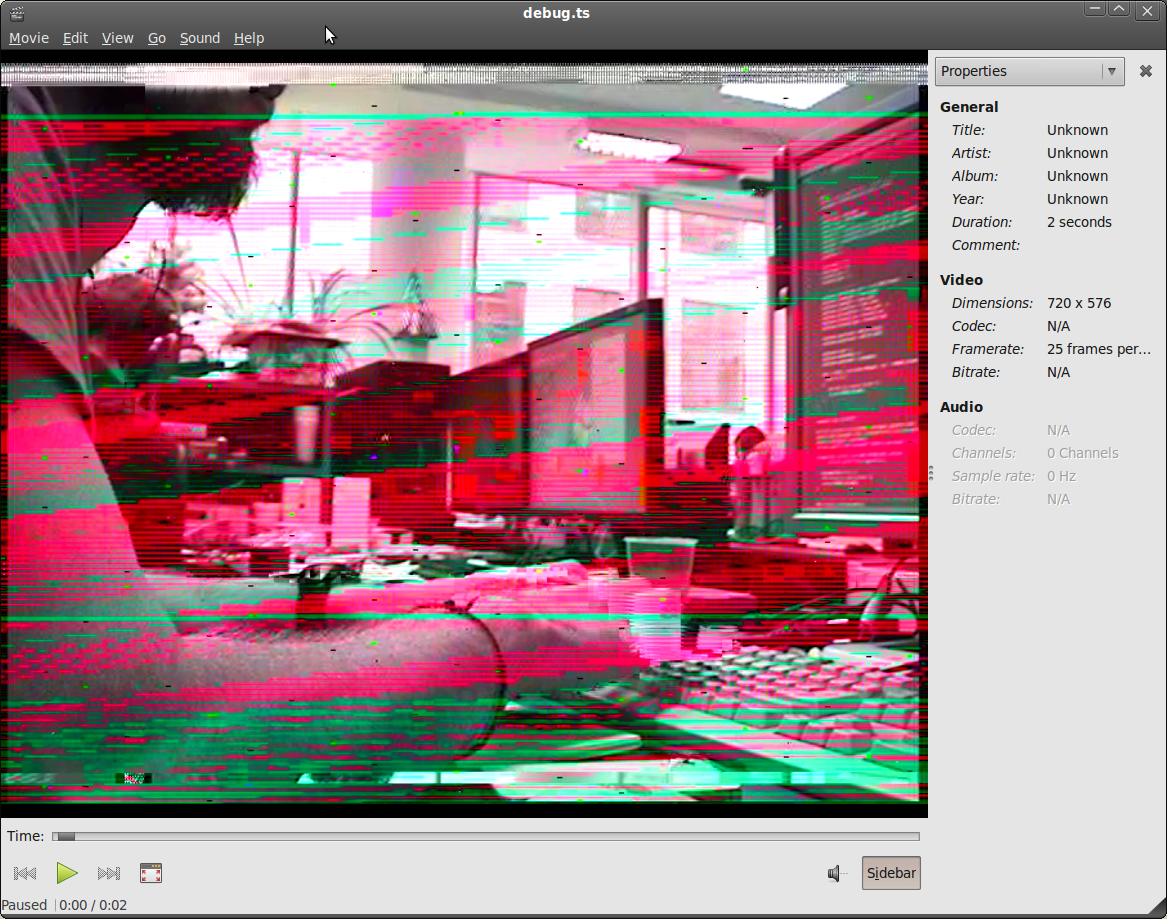

Is it possible to set custom resolution, e.g. 712x570 to h264 encoder?
    Which software are you using and what is you encoder version?
  • I use H.264 Base/Main/High Profile Encode Version 02.30.00.06 (Dec 2012) and DMAI
    I try to put in encoder buffer with 712x570 frame. If I set dimensions to 712x570 -> encoder crashing, if I set 720 x 576 it works, but image is like this
  • Can you share all the encoder parameters?

    And this is graphic buffer param:
    BufferGfx_calcDimensions(videoStd, colorSpace, &gfxAttrs.dim); // colorspace is yuv420sp
    gfxAttrs.dim.width = 720; // or 712
    gfxAttrs.dim.height = 576; // or 570
    gfxAttrs.dim.lineLength = Dmai_roundUp(BufferGfx_calcLineLength(gfxAttrs.dim.width, colorSpace), 32); // for 712x570 it calc linelength = 736
    gfxAttrs.colorSpace = colorSpace; // yuv420sp
    bufSize = gfxAttrs.dim.lineLength * gfxAttrs.dim.height * 3 / 2; //but i have frame which size is 712 * 570 * 3 / 2
    hVideoBufTab = BufTab_create(NUM_CAPTURE_BUFS, bufSize, BufferGfx_getBufferAttrs(&gfxAttrs));
    1.W.r.t snap shot, it seems like pitch is going wrong.
    2. Encoder should throw an error saying unsupported width/height. It shouldn't crash. You can refer the sample test application provided with your encoder package. Or try setting the resolution you want in sample test application.

    Finaly I finished simple videoloop app. Problem was in Display buffer. It needs linelength width is divided 32.
    for 712 it returning 736. I cutted off frame and got resolution 704x570. I think if I give to encoder 704x570 frame, it will work fine.
    Nice to know it got resolved.
    As said earlier it was pitch issue. Width of input frame in pixels. Input width can be changed before the start of encoding within the
    limits of maximum width set in creation phase. inputWidth must be multiples of two. Please refer user guide for more details.
