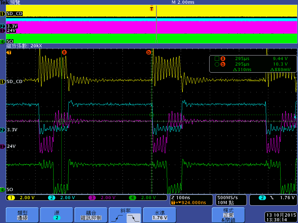

I work on TI AM335x IDK platform, the tools's version are as below.
CCS V6
am335x_sysbios_ind_sdk_1.1.0.8
bios_6_41_04_54
ndk_2_24_01_18
xdctools_3_30_06_67_core
I try to use GPMC to connect with FPGA and below is my setting.
HWREG(SOC_GPMC_0_REGS + GPMC_CONFIG1(csNum)) = 0x28001000;
HWREG(SOC_GPMC_0_REGS + GPMC_CONFIG2(csNum)) = 0x00050500;
HWREG(SOC_GPMC_0_REGS + GPMC_CONFIG3(csNum)) = 0x00020202;
HWREG(SOC_GPMC_0_REGS + GPMC_CONFIG4(csNum)) = 0x05000500;
HWREG(SOC_GPMC_0_REGS + GPMC_CONFIG5(csNum)) = 0x00050505;
HWREG(SOC_GPMC_0_REGS + GPMC_CONFIG6(csNum)) = 0x50000000;
HWREG(SOC_GPMC_0_REGS + GPMC_CONFIG7(csNum)) = 0xF50;
Ch1 is GPMC Clock
Ch2 is CS
Ch3 is OE
Ch4 is WE
As you can see, there is 310 ns between two success write/read.
My question is that is it possible to shorten the duration between two success write/read?
I have tried to change the value of GPMC_CONFIG6, but it seems no effect.
Could you give me some suggestion?
