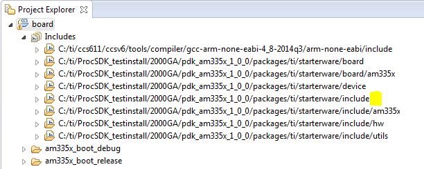

In CCSv6.1, I imported the board project from
C:\ti\pdk_am335x_1_0_0\packages\ti\starterware\board
but when I tried to build the project:

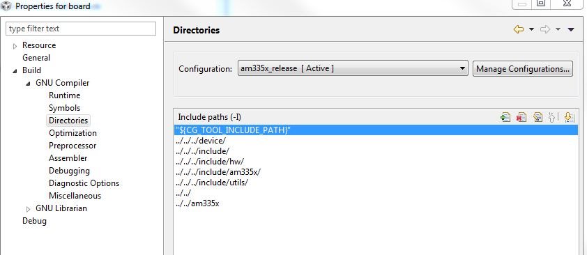

It seems to me that the (relative) include paths are specified incorrectly in the project files.  For example, "types.h" is located in
C:\ti\pdk_am335x_1_0_0\packages\ti\starterware\include
However, the include path that should have found this include file was specified as:
"${ORIGINAL_PROJECT_ROOT}/../../../include/"
where ORIGINAL_PROJECT_ROOT = C:\ti\pdk_am335x_1_0_0\packages\ti\starterware\board\ccs.  It has one too many "../"!
I seem to always have this problem with the starterware CCS projects.  Am I doing something wrong?  Why is it necessary to fix these paths all the time?  What is the easiest way to fix them?  Can TI fix the project files so that the user doesn't need to go back and fix them?
    I will forward this to the RTOS team.

  • Hi Brian,
    I was able to build the "board" project after importing it into my CCSv6.1 workspace without the errors that you are encountering (log attached).
    In order to ensure that we both have the same build environment, could you please delete the "board" project from your CCS workspace and re-import as default.
    After you do that, could you please post a screenshot of your /include folder (mine is below). As you have stated, the project cannot find types.h during the build. Its strange because this is specified in the compiler include path in the ccs project by default.
    If I deliberately break this path in the compiler include directory, it should be greyed out in the CCS project explorer /include window. Please post back your findings.
    Lali
    /cfs-file/__key/communityserver-discussions-components-files/791/6052.log.txt
  • I did a complete reinstall of the processor sdk and ccs, then imported the pdk/starterware/boards.  Here is the result:
    Like I said in my first post, the include files are specified incorrectly (they have an extra '..') in the .cprojects throughout the starterware source tree.
    Also your test does not use the default install location for the Processor SDK, so I believe it is not a valid test.

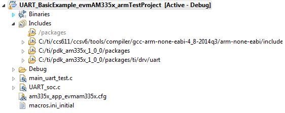

  • Also, when I try to create the PDK components example/test projects by using the pdkProjectCreate.bat script, I again get a lot of ccs projects with broken include files:
    Here is the output of my running the pdkProjectCreate.bat script:

  • Hi Brian,
    Was ${ORIGINAL_PROJECT_ROOT} added by you? could you please try removing that and leave ../../../include/ ?
    When I imported the project into CCS, this is what the paths look like by default.
    Lali
